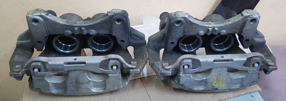

It seems like the caliper is the same for either rotor (and pads), just the bracket/support/mount is different. Can I just go with new caliper mounts, rotors, and pads from the AWD? Or do I need the bracket and caliper? If I put in the VIN for my FWD and for an AWD vehicle, I get same PN for calipers, different for rotors and brackets(supports), so not sure. Also they are referenced as "front vented 17" and 18 front vented. I assume that is for older years that still had 17 inch wheels standard (but all 2015+ have 18+ wheels).

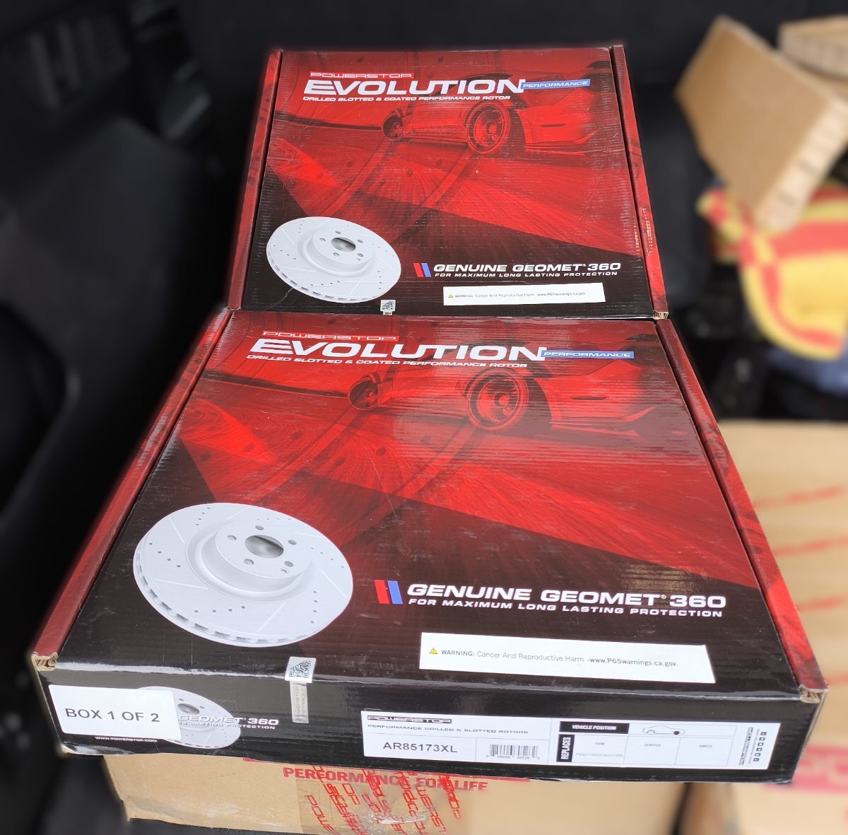

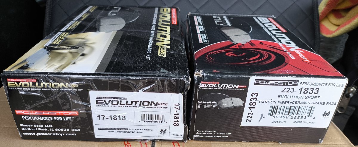

So this will finally happen! I am still waiting for the front caliper brackets to match the larger rotors, but Saturday is the day I hope! These front rotors are beefy. It is a daily driver for my wife, and it also gets about 20,000 miles a year, so I didn't go with drilled and slotted, or aggressive pads. I do drive it from time to time so I will appreciate the larger front brakes I hope. I don't really need the coated rotors either, I live in the desert and rust is not really an issue, but for the cost difference, I went with them. I do have pretty good luck with Power Stop brake parts, so I hope that continues.
$453 after shipping, $388 after $65 rebate. It is actually cheaper than the above screen shot since they have the same components in a kit, and I added slide pins and boots, and still cheaper. Shipping was $53 because it came from 2 different places, that 5% off discount of $20 didn't cover the shipping like it usually does. Still $100 cheaper than I can get it locally, with the $35 in shipping for the rotors (the shipping for the brackets is $15).

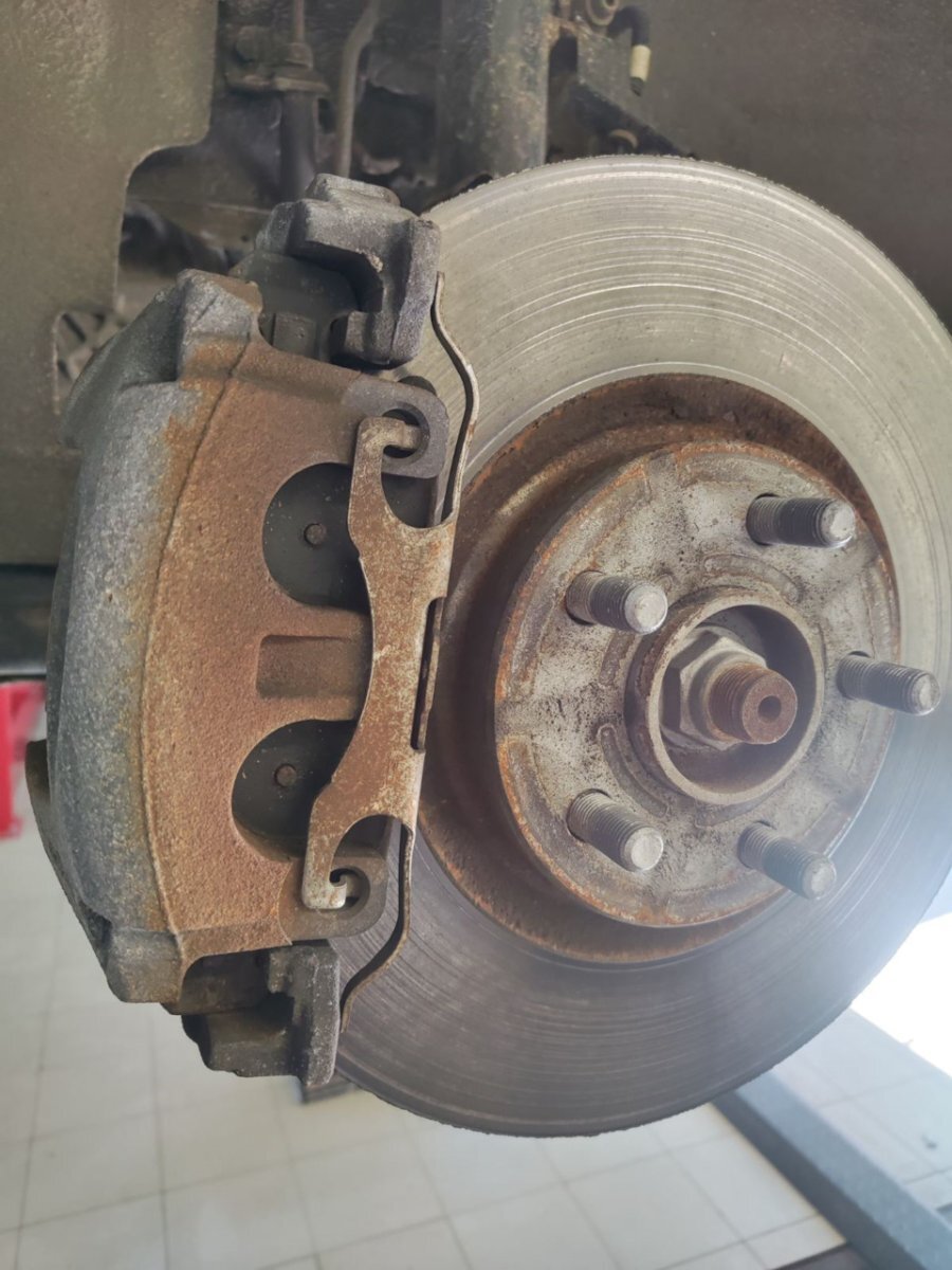

I forgot to wait for the 18 inch spare to arrive, but if I have a flat on the front the next 2 days, I will put the spare on the back (which I would likely do with a FWD vehicle anyways). Work is done, 5 hours, because I have no power tools, no lift, and ADHD so I scrubbed and details the back of the rims, the suspension, the brakes, the chassis, etc. It was the little things that kicked my butt. Replacing the rear caliper boots and slides, with the lower having the hard plastic, was a PITA.

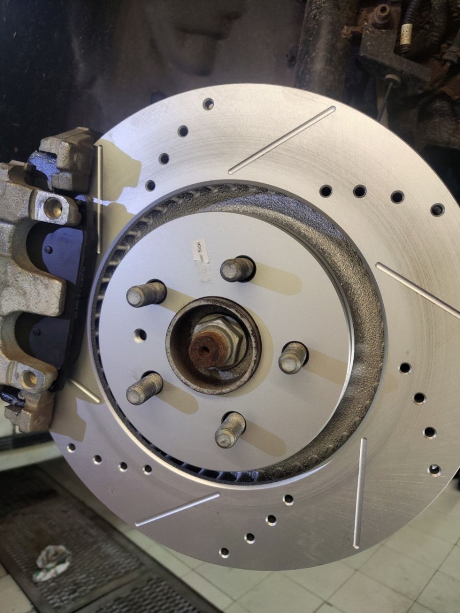

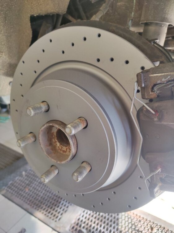

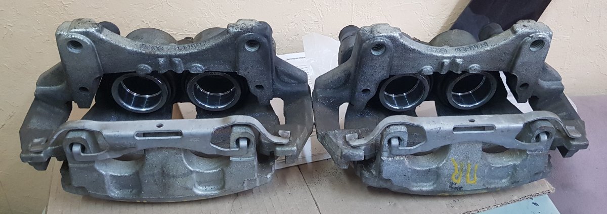

I didn't pay enough attention to the FWD being rear vented, and AWD being front vented. I didn't change the brake backing pad.
The magic that makes it happen, left is the FWD caliper bracket, right is the AWD bracket:
The different rotors:
There was way more rust than I am used to, with a CA and AZ car. but still pretty easy to work on.
The money shot:

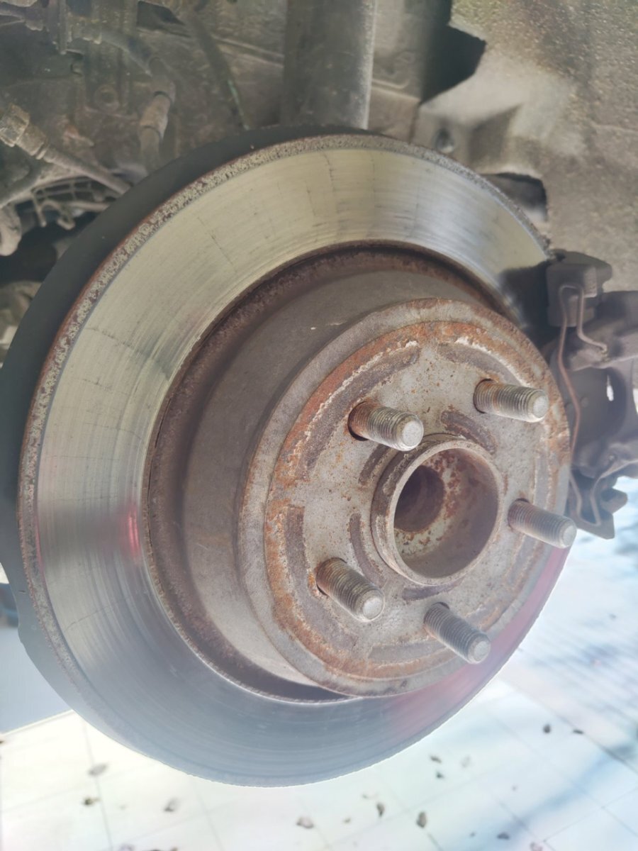

The real reason I dug into the brakes. Rear had 2-3mm left. It was starting to shake on normal braking, not just emergency or heavy braking coming down a mountain pass.

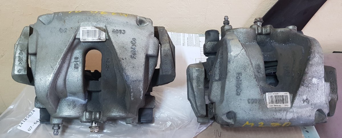

The ST caliper brackets are hard(er) to find except at the dealer. I Priced it all out and I just wasn't sold on the cost vs gain. Just the standard ST vs the Performance Brake package brakes.
I haven't tried, but I don't see why you couldn't do that on a 2018, the ST front caliper, rotors, or even the rear larger and vented rotors and calipers. The front ST calipers have 4mm larger pistons (x2 for each caliper), I doubt it is enough to require any other changes like master cylinder with more capacity, but I don't know.
