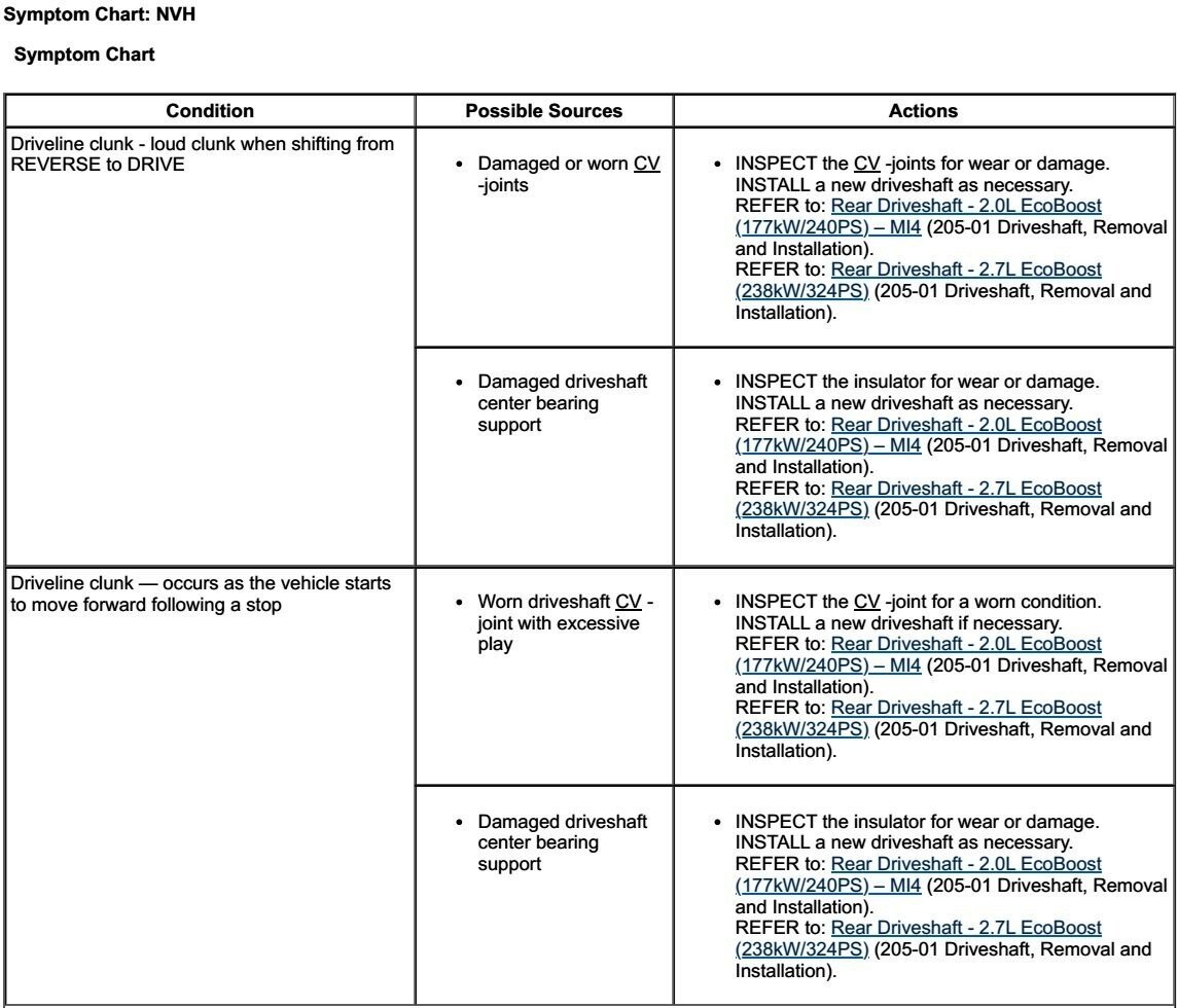

eric1 Posted June 23, 2024 Report Share Posted June 23, 2024 2019 Ford Edge Titanium AWD 85k miles (still under CPO powertrain warranty) Seems like if I’m at a dead stop and accelerate, often times while making a turn, I’ll hear & feel a clunk that seems to be coming from the rear middle of the car. Almost like it’s from the rear differential. Anyone have experience with this? Quote Link to comment Share on other sites More sharing options...
Haz Posted June 23, 2024 Report Share Posted June 23, 2024 From the 2019 Edge Workshop Manual... Related sections of the 2019 Edge Workshop Manual are attached below as PDF documents... Good luck! Driveshaft - Diagnosis and Testing - 2019 Edge Workshop Manual.pdf Rear Driveshaft - 2.0L EcoBoost - Removal and Installation - 2019 Edge Workshop Manual.pdf Rear Driveshaft - 2.7L EcoBoost - Removal and Installation - 2019 Edge Workshop Manual.pdf 2 1 Quote Link to comment Share on other sites More sharing options...
