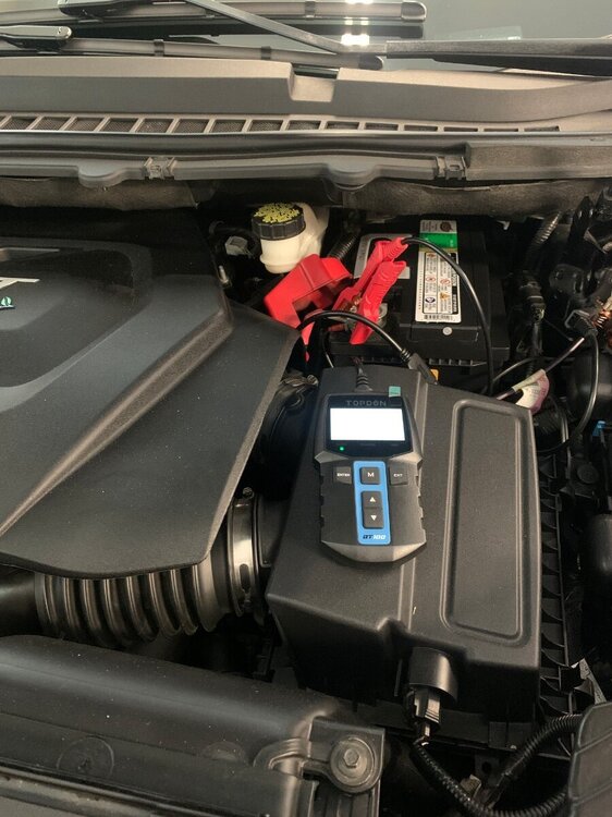

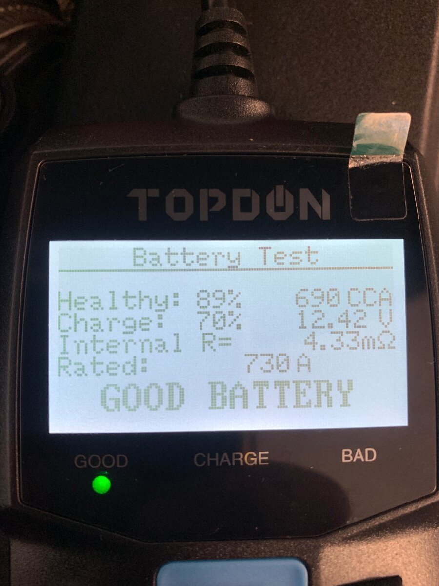

1004ron Posted June 22, 2024 Report Share Posted June 22, 2024 Here's what my 2.5yo battery reads this morning - vehicle hasn't been used for 3 days (its bike weather) - as can be seen, it's in perfect condition. Stop chasing your tail and get it tested properly. Quote Link to comment Share on other sites More sharing options...
