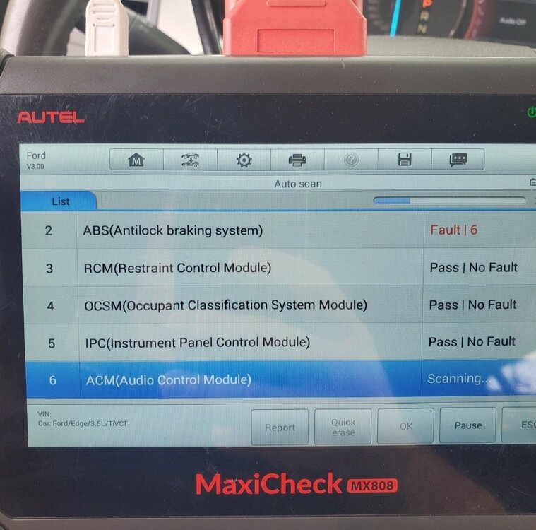

Tommie Posted June 19, 2024 Report Share Posted June 19, 2024 Hey everyone, i now own a 2011 facelift edge (fwd) and need to replace the abs pump, very easy job for me todo i just need to purchase the (cheapest) priced scantool to program/bleed it and dont know which to consider, thanks for your help. Quote Link to comment Share on other sites More sharing options...

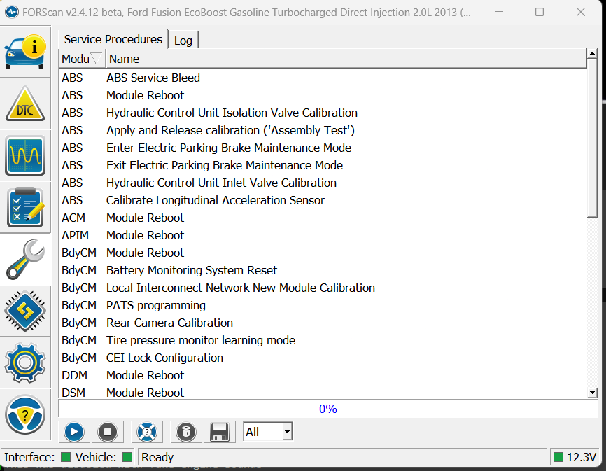

sc00by Posted June 25, 2024 Report Share Posted June 25, 2024 (edited) Froscan might be able to do it for you, I do not have the same year as you so I cannot check the service functions for your year. I believe there was a service procedure in forscan for my wife's fusion and if needed I could find out tonight. I guess let me know and I can take a look at the Fusion. Edit: Here are the service procedures available in forscan for the 2013 Fusion. Here are two adapters that will work with forscan: https://www.amazon.com/OBDLink-EX-FORScan-OBD-Adapter/dp/B081VQVD3F https://www.amazon.com/Vgate-vLinker-Adapter-FORScan-MS-CAN/dp/B094Z7PBLS/ Here is where to get forscan, you will need a windows laptop: https://forscan.org/home.html Edited June 25, 2024 by sc00by 1 Quote Link to comment Share on other sites More sharing options...
Tommie Posted June 26, 2024 Author Report Share Posted June 26, 2024 A freind is letting me borrow, next trying to source out a pump thats not made out of Gold. I wish it was rebuildable. Quote Link to comment Share on other sites More sharing options...
