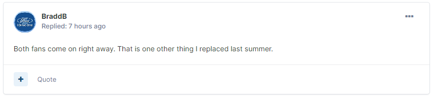

Haz Posted June 17, 2024 Report Share Posted June 17, 2024 (edited) Does the electric cooling fan(s) immediately run after you begin operating the A/C system? Good luck! Edited June 17, 2024 by Haz 1 Quote Link to comment Share on other sites More sharing options...
Haz Posted June 17, 2024 Report Share Posted June 17, 2024 Just checking, since inoperative cooling fans could explain A/C performance difference between vehicle stopped at idle and vehicle being driven at speed. Good luck! Quote Link to comment Share on other sites More sharing options...
