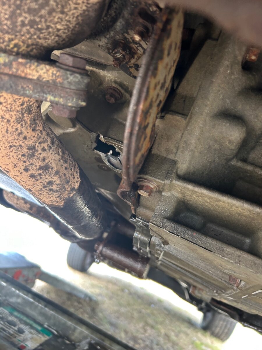

FL Res Posted June 13, 2024 Report Share Posted June 13, 2024 2008 Ford edge SEL As I was driving my wife’s edge to work there was a pop clank the engine cut off in the car coasted to a stop free wheel. Tooted home and discovered the transmission was dry so something blew out. I will include a picture. Couple questions it seems. It was a safety feature that the drivetrain broke free after the transmission failed; is this correct? Second question is when I went to tow the edge home I attempted to turn the engine over which it did not. Is there a reset that must take place? So now I’m looking at replacing a transmission this weekend. thanks Quote Link to comment Share on other sites More sharing options...
1004ron Posted June 13, 2024 Report Share Posted June 13, 2024 27 minutes ago, FL Res said: 2008 Ford edge SEL Couple questions it seems. It was a safety feature that the drivetrain broke free after the transmission failed; is this correct? Quote Never heard of such a thing and highly unlikely - what led to that train of thought? Second question is when I went to tow the edge home I attempted to turn the engine over which it did not. Is there a reset that must take place? So now I’m looking at replacing a transmission this weekend. thanks How did you attempt to turn the engine? - use a wrench on the crank main pulley bolt? Quote Link to comment Share on other sites More sharing options...
FL Res Posted June 14, 2024 Author Report Share Posted June 14, 2024 No, I was trying to get it on the car dolly and just turned the key to see what happened. turning the crank will be Saturday Quote Link to comment Share on other sites More sharing options...
