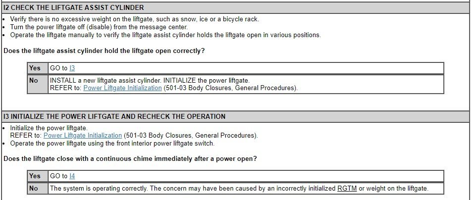

The following, from the 2016 Edge Workshop Manual, is an edited version of Power Liftgate diagnostic Pinpoint Test "I", aimed toward evaluating the gas-filled lift assist strut...
Possible Causes
  • Excessive weight on the liftgate, such as snow, ice or a bicycle rack
  • Liftgate assist cylinder
  • Power liftgate initialization

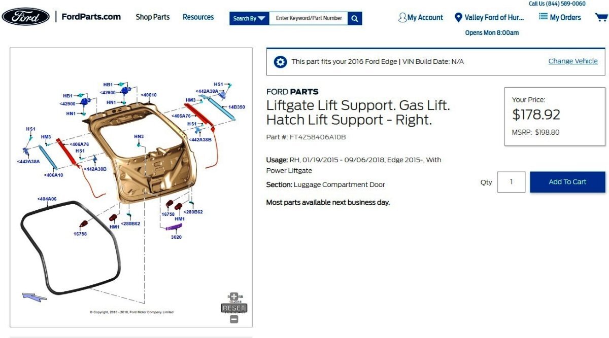

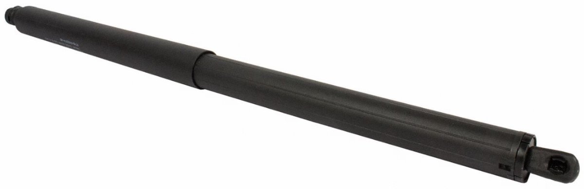

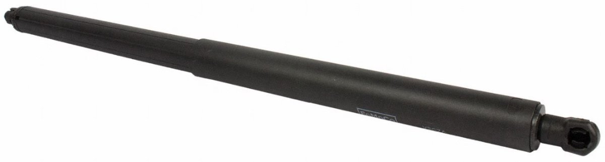

PowerLiftgate-Gas-FilledLiftAssistStrutRightSide-FordPartFT4Z58406A10B-FordParts_comListing.thumb.jpg.51f95223f8ee3ebbb5b7ec2954dc21a2.jpg
PowerLiftgate-Red-OvaledGasFilledLiftAssistStrutExplodedViewofVariousComponents-FordParts_com1.thumb.jpg.e81e31c04a0685b57bb8997076992dec.jpgPowerLiftgate-Gas-FilledLiftAssistStrutRightSide-FordPartFT4Z58406A10B-FordParts_com1.thumb.jpg.a7280fccfa156abf35587debc44da47c.jpgPowerLiftgate-Gas-FilledLiftAssistStrutRightSide-FordPartFT4Z58406A10B-FordParts_com3.thumb.jpg.008e1607a7bc862c076b5a75fdfc6a4c.jpgPowerLiftgate-Gas-FilledLiftAssistStrutRightSide-FordPartFT4Z58406A10B-FordParts_com2.thumb.jpg.17c2b95a5d53311fb5cfa23731423546.jpg
Web searching the Ford part number will likely many online sellers and lower pricing.
If the Liftgate cylinder supports the Liftgate at all positions, then you may want to perform the Power Liftgate Initialization procedure from the Edge Workshop Manual...

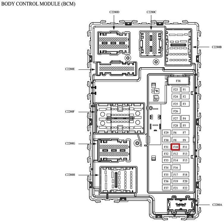

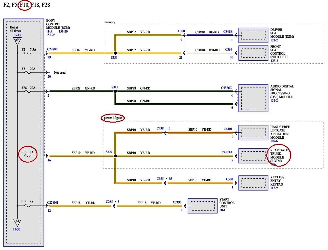

The wiring diagram shows the Rear Gate Trunk Module (RGTM) power is protected by Fuse 10 (5-amp)...
RearGateTrunkModule(RGTM)-PowerDistributionWiringDiagramwModuleFuse10HIGHLIGHTED-2016Edge.thumb.jpg.32deb20e56f79b2a1088bc5074a79f80.jpg
BodyControlModule(BCM)-LocationIllustration-2016Edge.thumb.jpg.8a6c14cec3faea18d122c481c64d9d96.jpg
BodyControlModule(BCM)-IllustrationHIGHLIGHTINGRED-BoxedLGTMFuse10Location-2016Edge.thumb.jpg.b29b76f053aa23aebd8b401e712b38f6.jpg
If neither of these courses of action yield improvement, you may want to get your Edge's modules scanned for Diagnostic Trouble Codes (DTCs), perhaps at a National Brand auto parts store or your favorite neighborhood parts store, then please report back and we'll consider additional diagnostic procedures.
