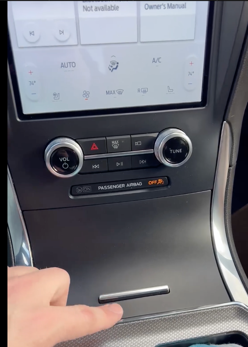

GTEyes Posted June 8, 2024 Report Share Posted June 8, 2024 Hello, I see some folks have installed the below part so the wireless charger area has a cover as it used to on earlier models. Has anyone done this? Curious what the process is for getting access to install the part. Part Number seems to be KT4B-R044C-16-C 1 Quote Link to comment Share on other sites More sharing options...
Haz Posted June 8, 2024 Report Share Posted June 8, 2024 Ford Edge owners re-contenting Ford's de-contenting of their vehicles -- Fabulous! Though, with apologies to Poe's Raven, quoth-ing Ford, "Warrantable? Nevermore." Now, onto the documents... Differences between disassembly steps in the below-attached sections of the 2020 & 2021 Edge Workshop Manuals may provide you the insights you're seeking. Please note: Some numbered action steps, which apply to their immediately-following illustrations, may appear on the page before their rightful illustration. We especially look forward to your photos. Good luck! Front Controls Interface Module (FCIM) - Removal and Installation - 2020 Edge Workshop Manual.pdf Floor Console - Removal and Installation - 2021 Edge Workshop Manual.pdf 1 Quote Link to comment Share on other sites More sharing options...

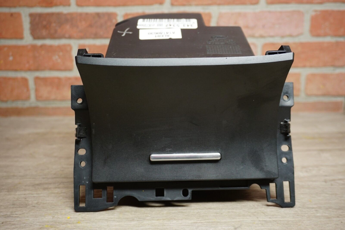

Haz Posted June 8, 2024 Report Share Posted June 8, 2024 FordParts.com lists varied part numbers for the bin-with-hinged-door assembly, based upon Door Color Finish/2020 Vehicle Build Date/Additional Equipment... Link to the FordParts.com components illustration above, which is zoomable and scrollable in your web browser, shown below edited as isolated view, for clarity... Good luck! 1 Quote Link to comment Share on other sites More sharing options...
