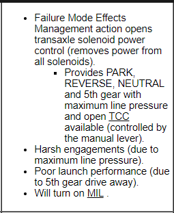

Haz Posted June 8, 2024 Report Share Posted June 8, 2024 Just curious if the vehicle exhibited any of the expected P0715 failure mode management symptoms beyond the Malfunction Indicator Lamp (MIL)... Good luck! 3 Quote Link to comment Share on other sites More sharing options...
fowis Posted June 9, 2024 Author Report Share Posted June 9, 2024 Yes, I experience the following symptoms: * harsh engagement * Poor launch performance * MIL is turned on On 6/7/2024 at 12:46 PM, 1004ron said: 1 Quote Link to comment Share on other sites More sharing options...
