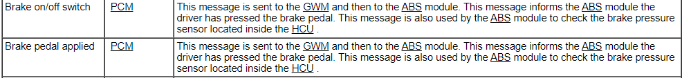

I'm not immediately familiar with your scanner without downloading and reading its User Guide, but perhaps you can try powering up your scanner with your Edge in Key On Engine Off state -- that is, advancing past Accessory to its Ignition being On, but without performing a Start button push -- since starting your Edge requires brake pedal actuation -- which causes the Powertrain Control Module (PCM) to transmit...

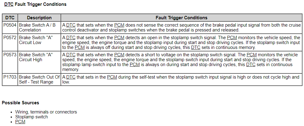

Additionally, if the Stoplamp Switch component of the BPP has been stuck in always-on position, some of the following DTCs should be present in the PCM...

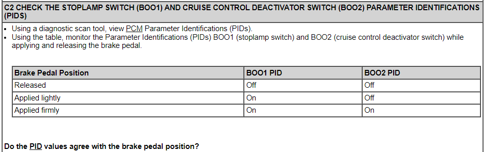

If Accessory On-to-Ignition On pushbutton functionality does not return, put Fuse 54 back in the BJB, start up your Edge's engine, turn off all accessory functions, then power up your scanner and once it's fully operational, scan for DTCs.  Make note of what -- if any -- DTCs are present, and then clear them.
If no DTCs are present, use you scanner to perform the following diagnostic test step to assess operation of the BPP functions...
