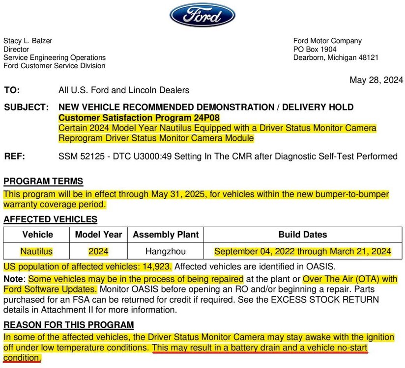

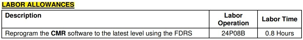

Customer Satisfaction Program 24P08 - 2024 Nautilus - 09/04/22 through 03/21/2024 Build Dates - Equipped with a Driver Status Monitor Camera - Reprogram Driver Status Monitor Camera Module - ***No Owner Letter Will Be Mailed***

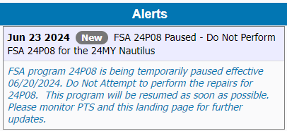

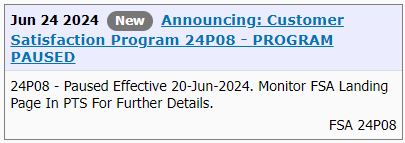

Dealers are being informed via Ford's Professional Technician System (PTS) website to pause their actions under Customer Satisfaction Program 24P08 due to software issues...
