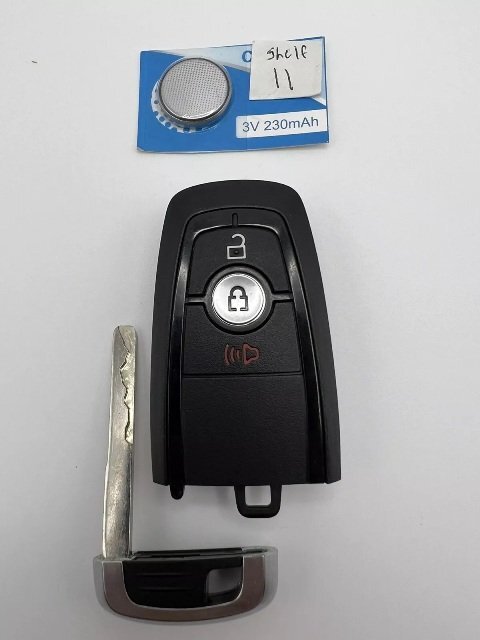

Providing information here, previously shared with @pjtaxi via Forum Messaging, regarding the initial key fob post...
Thanks for providing me your Edge's VIN, which allowed me to call up a Ford report called the Historical Vehicle Bill of Material (HVBoM), which lists the original part numbers of all identified parts assembled into your specific Edge.
The HVBoM states the original Ford part number for the keyless entry fobs supplied with your Edge was HC3T-15K601-AD. This is the three-button fob that you've describing as currently having.
FordThree-ButtonKeyFob-FordServicePartHC3Z-15K601-G.jpg.169f80a0c7f2cef1f6999512143a62a2.jpg
(This image is from an inactive eBay ad from which the fobs are sold out)
Presently, the Ford part number to replace the originally supplied fobs is HC3Z-15K601-G.
Good luck!
