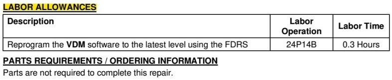

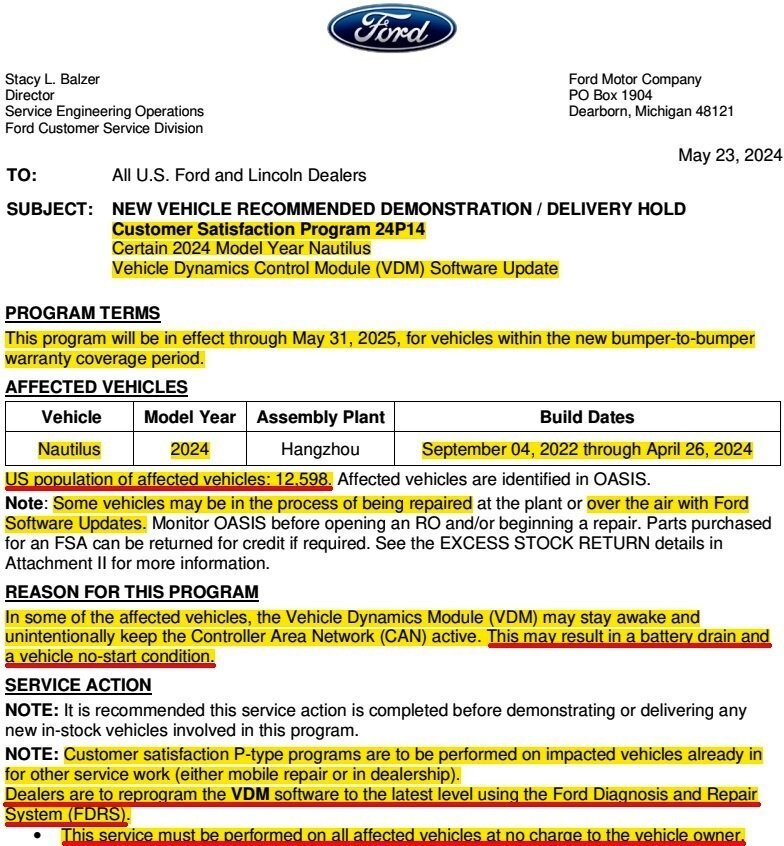

Customer Satisfaction Program 24P14 - 2024 Nautilus - 09/04/22 through 04/26/2024 Build Dates - Vehicle Dynamics Module (VDM) Software Update - ***No Owner Letter Will Be Mailed***
Haz

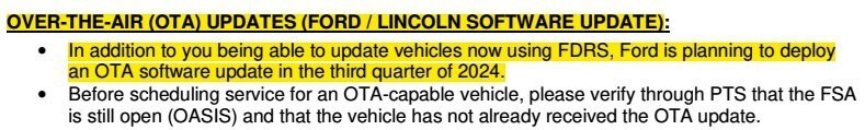

Thanks as always, Haz!  I've repromulgated this to the other sites I regularly monitor.  I've flagged the "OTA in Q3" part, so users will know they should ping their dealer directly if they don't want to wait (the letter sounds like dealer tech staff should have access to the update already, using FDRS).  Based on date range and number of affected vehicles it sounds like this impacts both ICE and hybrid.
