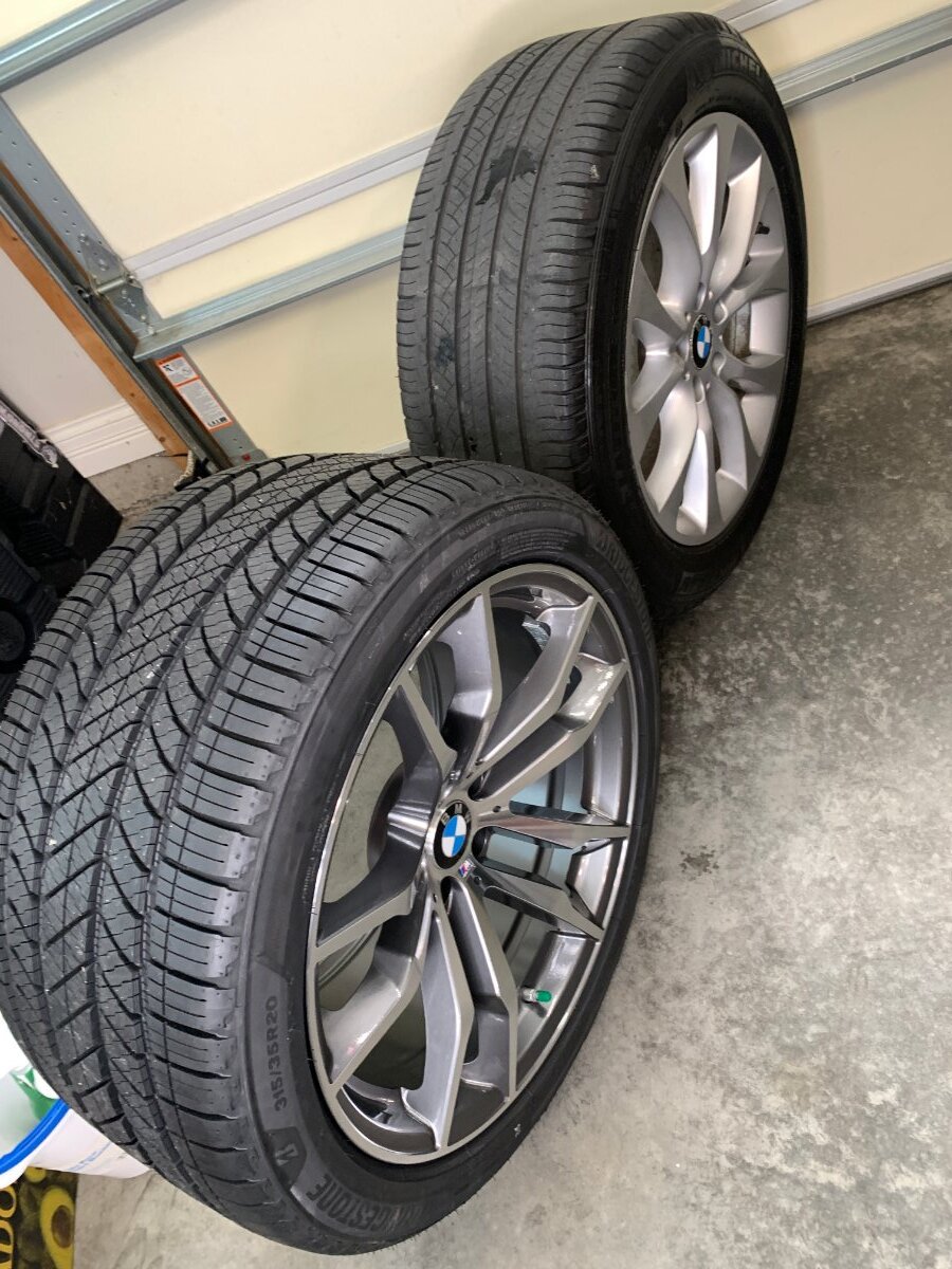

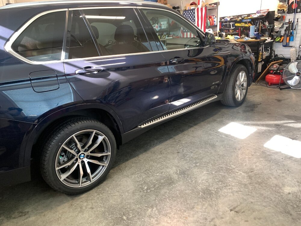

1004ron Posted May 18, 2024 Report Share Posted May 18, 2024 38 minutes ago, edgeidiot said: Purely, wider tires come with increased circumference. It is purely guesswork to see if a tire will fit. Having just gone from 19" 255mm wide tires to 20" 315mm tires while maintaining the circumference I can confidently say your statement is incorrect. Rim width went from 9" to 11". Using the below web site you can access the overall dimensions changing rim diameter, width and offset. https://www.willtheyfit.com/index.php?width=255&aspect=50&diameter=19&wheelwidth=9&offset=37&width2=315&aspect2=35&wheel_size=20&wheel_width=11&offset2=28 I did not use "guesswork". 1 1 Quote Link to comment Share on other sites More sharing options...

1004ron Posted May 19, 2024 Report Share Posted May 19, 2024 (edited) 1 hour ago, edgeidiot said: Yes, I can see that they fit. What I notice is that your new tire (315/35R20) is two inches less in diameter than the old tire (255/50R19.) It may cause increased wear because of the reduced diameter and a greater speedometer error. Did you view the link I posted? Where/how did you arrive at a diameter difference of two inches? The diameter difference is 9.1mm i.e. 0.36 inch. Reading at 30mph = 30.37mph Edited May 19, 2024 by 1004ron 1 Quote Link to comment Share on other sites More sharing options...
garycrist Posted May 19, 2024 Report Share Posted May 19, 2024 Hey @1004ron, are those BMW wheels? Quote Link to comment Share on other sites More sharing options...
1004ron Posted May 19, 2024 Report Share Posted May 19, 2024 14 minutes ago, garycrist said: Hey @1004ron, are those BMW wheels? Not official BMW OEM. https://www.ebay.com/itm/235369028013 1 Quote Link to comment Share on other sites More sharing options...
garycrist Posted May 19, 2024 Report Share Posted May 19, 2024 Tricky, tricky, tricky. Airplane props on a ST!😉 Quote Link to comment Share on other sites More sharing options...
