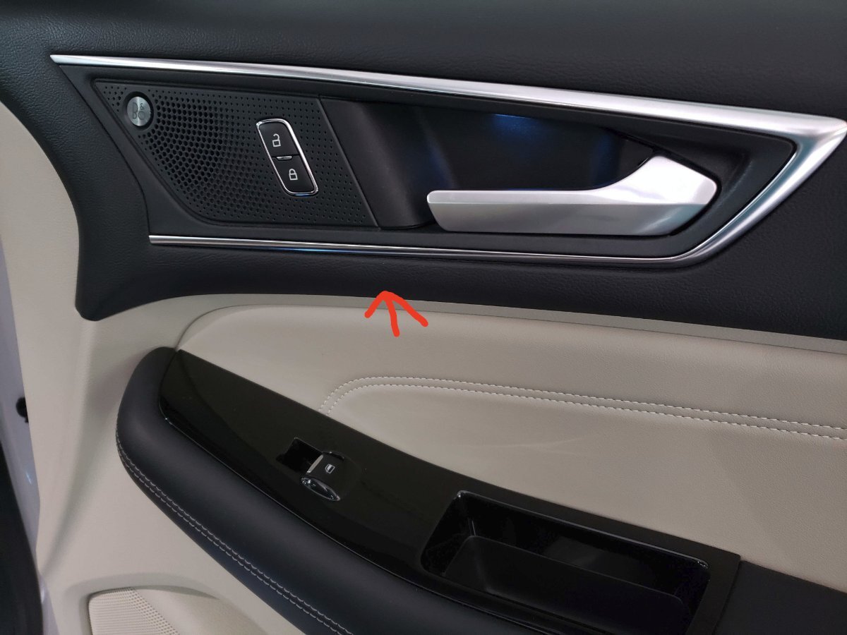

SMR2818 Posted May 14, 2024 Report Share Posted May 14, 2024 Getting a rattle noise on the door panel for both front doors, only happens when driving over rough road and stops when I press lightly where the arrow is pointing. Any ideas for a solution? Quote Link to comment Share on other sites More sharing options...
Tim W. AZ Posted May 15, 2024 Report Share Posted May 15, 2024 (edited) Is it a rattle from inside the door, or two surfaces rubbing together? Try spraying a small amount of silicon spray at the arrow, tighten any accessible screws and push on the outer edge to secure the door panel pinch clips. Squeaks drive me nuts. Edited May 15, 2024 by Tim W. AZ Quote Link to comment Share on other sites More sharing options...
