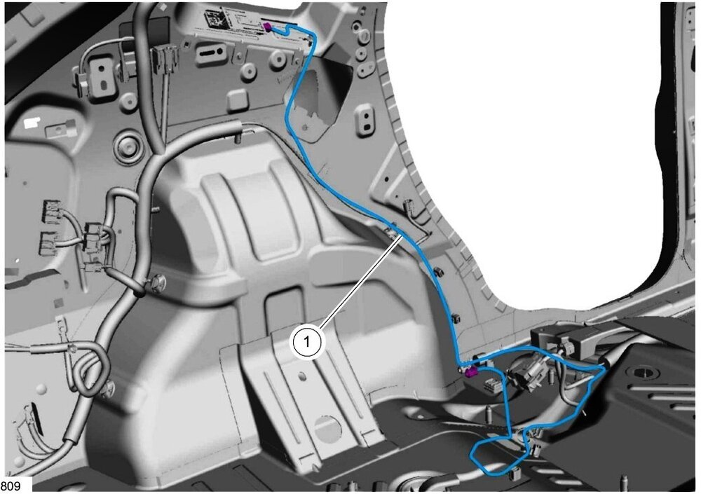

What is the electronic module that sits in a compartment in the plastic tray under the rear floor/cover?
Rchalk
From the 2020 Edge Workshop Manual...
Telematics Control Unit (TCU) Module
The TCU connects the vehicle to a cellular network. It contains a non-serviceable internal SIM card.
The TCU requires PMI when it is replaced.
TCU Antenna
The TCU antenna is used is used to boost reception for incoming and outgoing cellular network data. It is a compact, cellular phone type, planar inverted-F antenna.
TCUAntennaCableImage-2020EdgeWorkshopManual.thumb.jpg.f91d85ebb6b2f6780c7356474dfeebd3.jpg
TCU Antenna Cable Routing
TCUAntennaCableRoutingImage-2020EdgeWorkshopManual.thumb.jpg.1fd3e773f7a19835188e7426ad195bc8.jpg
