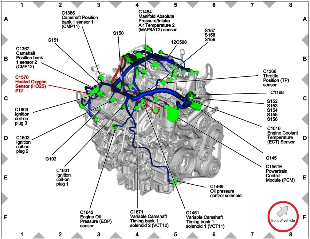

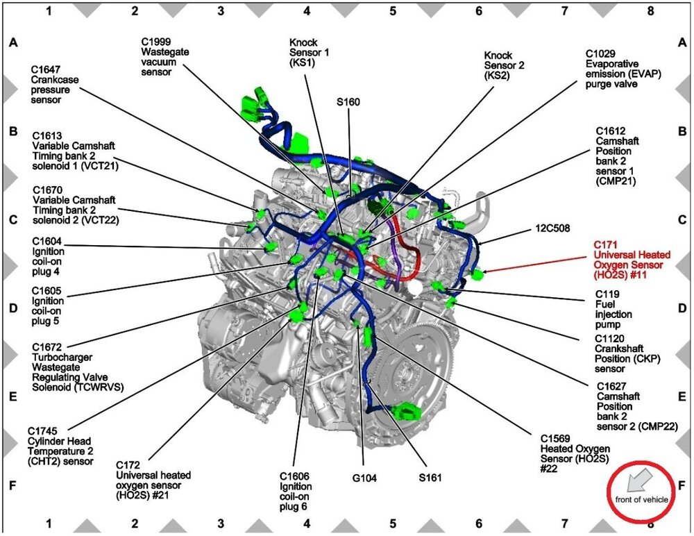

Haz Posted May 9, 2024 Report Share Posted May 9, 2024 The Workshop Manual is not explicit, but the 2015 Edge Wiring resource may be helpful... According to the following Component Location diagrams that depict four (4) Heated Oxygen Sensor (HO2S) and their red-lettered electrical Connector designations, Bank 1 is located on the backside of the engine and Bank 2 is located on the front side of the engine. Take note of the lower right corner red-circled arrow, which signals direction to Front of vehicle... Universal Heated Oxygen Sensor (HO2S) #11 - Connector C171 Location - 2.7L EcoBoost - 2015 Edge Heated Oxygen Sensor (HO2S) #12 - Connector C1570 Location - 2.7L EcoBoost - 2015 Edge Universal Heated Oxygen Sensor (HO2S) #21 - Connector C172 Location - 2.7L EcoBoost - 2015 Edge Heated Oxygen Sensor (HO2S) #22 - Connector C1569 Location - 2.7L EcoBoost - 2015 Edge On 5/8/2024 at 3:46 PM, cota86 said: Appreciate it but which one is bank 1 sensor 2? The diagrams aren't explicit, as to HO2S designations, but I think, provide us a roadmap to the answer by looking to blue-circled listing in this portion of the last diagram above... ...where the example Bank & Sensor designation is expressed in the parentheses as CMP22. Extending that designation model to your question: Bank 1 Sensor 2 is Universal Heated Oxygen Sensor (HO2S) #21. While it's unclear what diagnostic method(s) and diagnostic tool(s) you've employed to target this specific Sensor, perhaps disconnecting its Connector C172 while monitoring whatever it is you're using, may verify this hopeful identification. Or you might disconnect another of the HO2S connectors with similar monitoring for comparable verification. Relevant Wiring Reference selections are attached below as PDF documents... The Ford Powertrain Control/Emissions Diagnosis Manual provides the following useful component & monitoring system descriptions... Universal Heated Oxygen Sensor (HO2S) The universal HO2S, sometimes referred to as a wideband oxygen sensor, uses the typical HO2S combined with a current controller in the PCM to infer an air to fuel ratio relative to the stoichiometric air to fuel ratio. This is accomplished by balancing the amount of oxygen ions pumped in or out of a measurement chamber within the sensor. The typical HO2S within the universal HO2S detects the oxygen content of the exhaust gas in the measurement chamber. The oxygen content inside the measurement chamber is maintained at the stoichiometric air to fuel ratio by pumping oxygen ions in and out of the measurement chamber. As the exhaust gasses get richer or leaner, the amount of oxygen that must be pumped in or out to maintain a stoichiometric air to fuel ratio in the measurement chamber varies in proportion to the air to fuel ratio. The amount of current required to pump the oxygen ions in or out of the measurement chamber is used to measure the air to fuel ratio. The measured air to fuel ratio is actually the output from the current controller in the PCM and not a signal that comes directly from the sensor. The universal HO2S also uses a self contained reference chamber to make sure an oxygen differential is always present. The oxygen for the reference chamber is supplied by pumping small amounts of oxygen ions from the measurement chamber into the reference chamber. The universal HO2S does not need access to outside air. Part to part variance is compensated for by placing a resistor in the connector. This resistor trims the current measured by the current controller in the PCM. The universal HO2S heater is embedded with the sensing element allowing the engine to enter closed loop operation sooner. The heating element heats the sensor to a temperature of 780°C to 830°C (1,436°F to 1,526°F). The VPWR circuit supplies voltage to the heater. The PCM controls the heater ON and OFF by providing the ground to maintain the sensor at the correct temperature for maximum accuracy. Heated Oxygen Sensor (HO2S) The HO2S detects the presence of oxygen in the exhaust and produces a variable voltage according to the amount of oxygen detected. A high concentration of oxygen (lean air to fuel ratio) in the exhaust produces a voltage signal less than 0.4 volt. A low concentration of oxygen (rich air to fuel ratio) produces a voltage signal greater than 0.6 volt. The HO2S provides feedback to the PCM indicating air to fuel ratio in order to achieve a near stoichiometric air to fuel ratio of 14.7:1 during closed loop engine operation. When the oxygen sensor is cold, disconnected or on initial start up, the voltage may read between 1.5 to 1.7 volts. The oxygen sensor voltage will decrease to the normal operating range of 0.0 to 1.1 volts during warm, stabilized engine running conditions. The HO2S heater is embedded with the sensing element. The heating element heats the sensor to a temperature of 800°C (1,472°F). At approximately 300°C (572°F) the engine enters closed loop operation. The VPWR circuit supplies voltage to the heater. The PCM turns the heater ON by providing the ground when the correct conditions occur. The heater allows the engine to enter closed loop operation sooner. The use of this heater requires the HO2S heater control to be duty cycled, to prevent damage to the heater. Heated Oxygen Sensor (HO2S) Monitor The HO2S monitor is an on board strategy designed to monitor the heated oxygen sensors for concerns or deterioration which can affect emissions. The fuel control or stream 1 HO2S are checked for correct output voltage and response rate. Response rate is the time it takes to switch from lean to rich or rich to lean. The rear or stream 2 HO2S is monitored for correct output voltage and is used for catalyst monitoring and fore aft oxygen sensor (FAOS) control. Input is required from the camshaft position (CMP) sensor, the crankshaft position (CKP) sensor, the engine coolant temperature (ECT) sensor or the cylinder head temperature (CHT) sensor (if equipped), the fuel rail pressure temperature (FRPT) sensor, the fuel tank pressure (FTP) sensor, the intake air temperature (IAT) sensor, the mass airflow (MAF) sensor (if equipped), the manifold absolute pressure (MAP) sensor, the throttle position (TP) sensor and vehicle speed to activate the HO2S monitor. The fuel system monitor and misfire detection monitor must also have completed successfully before the HO2S monitor is enabled. The HO2S senses the oxygen content in the exhaust flow. The typical HO2S outputs a voltage between 0 and 1.0 volt. Lean of stoichiometric, air to fuel ratio of approximately 14.7:1, the HO2S generates a voltage between 0 and 0.45 volt. Rich of stoichiometric, the HO2S generates a voltage between 0.45 and 1.0 volt. The current required to maintain the universal HO2S at 0.45 volt is used by the PCM to calculate the air to fuel ratio. The HO2S monitor evaluates the HO2S for correct function. The time between HO2S switches is monitored after vehicle startup and during closed loop fuel conditions. Excessive time between switches or no switches since startup indicates a concern. Since lack of switching concerns can be caused by HO2S concerns or by shifts in the fuel system, DTCs are stored that provide additional information for the lack of switching concern. Different DTCs indicate whether the sensor always indicates lean, rich, or disconnected. The HO2S signal is also monitored for high voltage, in excess of 1.1 volts. An over voltage condition is caused by a HO2S heater or battery power short to the HO2S signal line. A functional test of the rear HO2S is done during normal vehicle operation. The peak rich and lean voltages are continuously monitored. Voltages that exceed the calibrated rich and lean thresholds indicate a functional sensor. If the voltages have not exceeded the thresholds after a long period of vehicle operation, the air to fuel ratio may be forced rich or lean in an attempt to get the rear sensor to switch. This situation normally occurs only with a green, less than 804.7 km (500 miles), catalyst. If the sensor does not exceed the rich and lean peak thresholds, a concern is indicated. Also, a deceleration fuel shut off rear HO2S response test is done during a deceleration fuel shut off (DFSO) event. Carrying out the HO2S response test during a DFSO event helps to isolate a sensor concern from a catalyst concern. The response test monitors how quickly the sensor switches from a rich to lean voltage. It also monitors if there is a delay in the response to the rich or lean condition. If the sensor responds very slowly to the rich to lean voltage switch or is never greater than a rich voltage threshold or less than a lean voltage threshold, a concern is indicated. The malfunction indicator lamp (MIL) is activated after a concern is detected on 2 consecutive drive cycles. Good luck! Heated Oxygen Sensor (HO2S) #12 - Connector C1570 Circuit-Pin Details - 2.7L EcoBoost - 2015 Edge.pdf Heated Oxygen Sensor (HO2S) #22 - Connector C1569 Circuit-Pin Details - 2.7L EcoBoost - 2015 Edge.pdf Heated Oxygen Sensors (HO2S) #11, #12, #21, #22 -Wiring Diagram - 2.7L EcoBoost - 2015 Edge.pdf Universal Heated Oxygen Sensor (HO2S) #11 - Connector C171 Circuit-Pin Details - 2.7L EcoBoost - 2015 Edge.pdf Universal Heated Oxygen Sensor (HO2S) #21 - Connector C172 Circuit-Pin Details - 2.7L EcoBoost - 2015 Edge.pdf 2 Quote Link to comment Share on other sites More sharing options...
