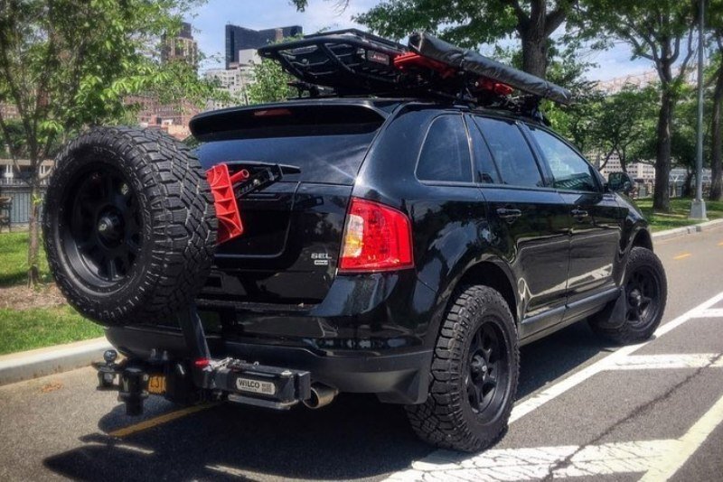

Haz Posted June 6, 2024 Report Share Posted June 6, 2024 If your vehicle is equipped with a trailer hitch, there is always room on the Back Porch... From Basecamp Brooklyn Good luck! 3 1 Quote Link to comment Share on other sites More sharing options...
