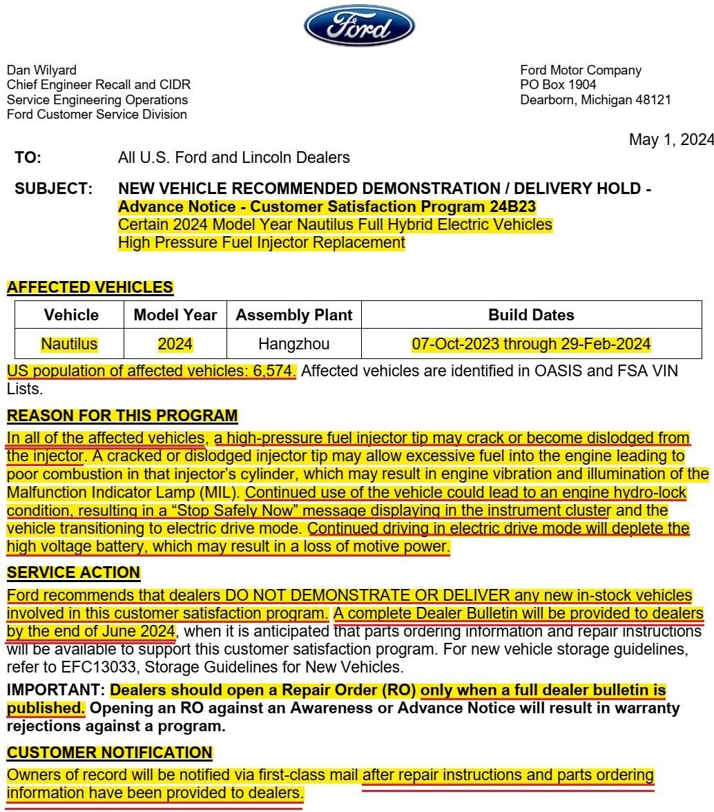

*** This is an advanced notice to dealers of Customer Satisfaction Program 24B23 -- This post will be updated when additional information becomes available ***
Highlights
  • Ford recommends that dealers DO NOT DEMONSTRATE OR DELIVER any new in-stock vehicles involved in this Customer Satisfaction Program.
  • US population of affected vehicles: 6,574.
  • In all of the affected vehicles, a high-pressure fuel injector tip may crack or become dislodged from the injector.
  • Continued use of the vehicle could lead to an engine hydro-lock condition, resulting in a “Stop Safely Now” message displaying in the instrument cluster and the vehicle transitioning to electric drive mode.
  • Continued driving in electric drive mode will deplete the high voltage battery, which may result in a loss of motive power.
  • Dealers cannot begin repair of affected vehicles until the Full Notification To Dealers is released, likely by the end of June, 2024.
  • This advance notice was conveyed to dealership Service personnel via Ford's OASIS system on May 2, 2024.
CustomerSatisfactionProgram24B23-AdvanceNoticetoDealers-HIGHLIGHTED.thumb.jpg.175116b4d3407ae41e8516a335347817.jpg

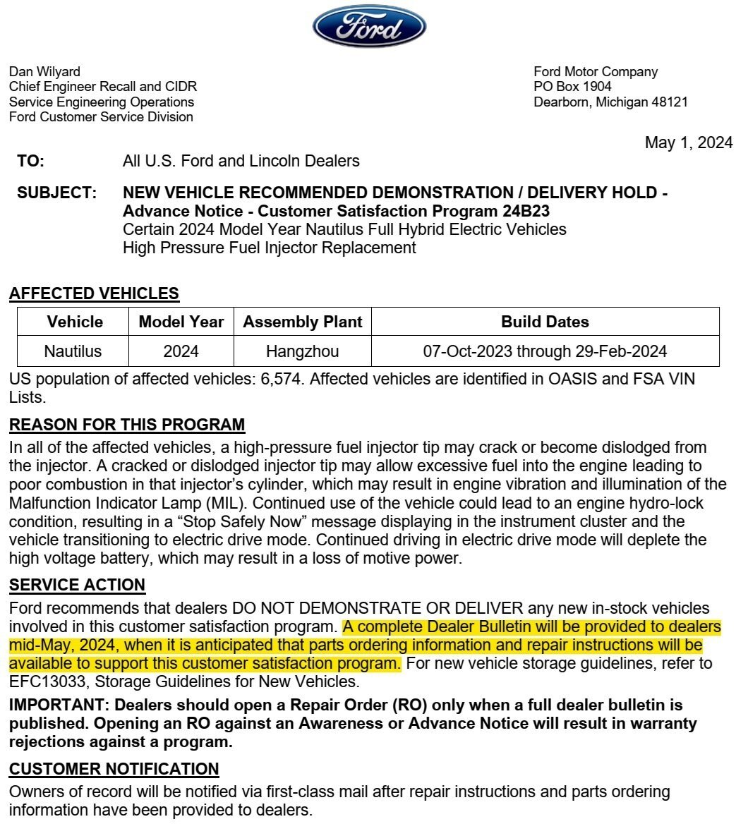

@markfm has rightfully observed that the Ford of Canada Advance Notice states the Full Dealer Notice is expected by the end of May 2024, which I overlooked in my haste to post that communication...
A Version 2 of the U.S. Advance Notice letter has now been issued, showing Mid-May 2024 for issuance of the Complete Dealer Bulletin...
CustomerSatisfactionProgram24B23-AdvanceNoticetoDealers-VERSION2-HIGHLIGHTED.thumb.jpg.2da3b175a04eea98f2af7e49152f3667.jpg
Good luck!

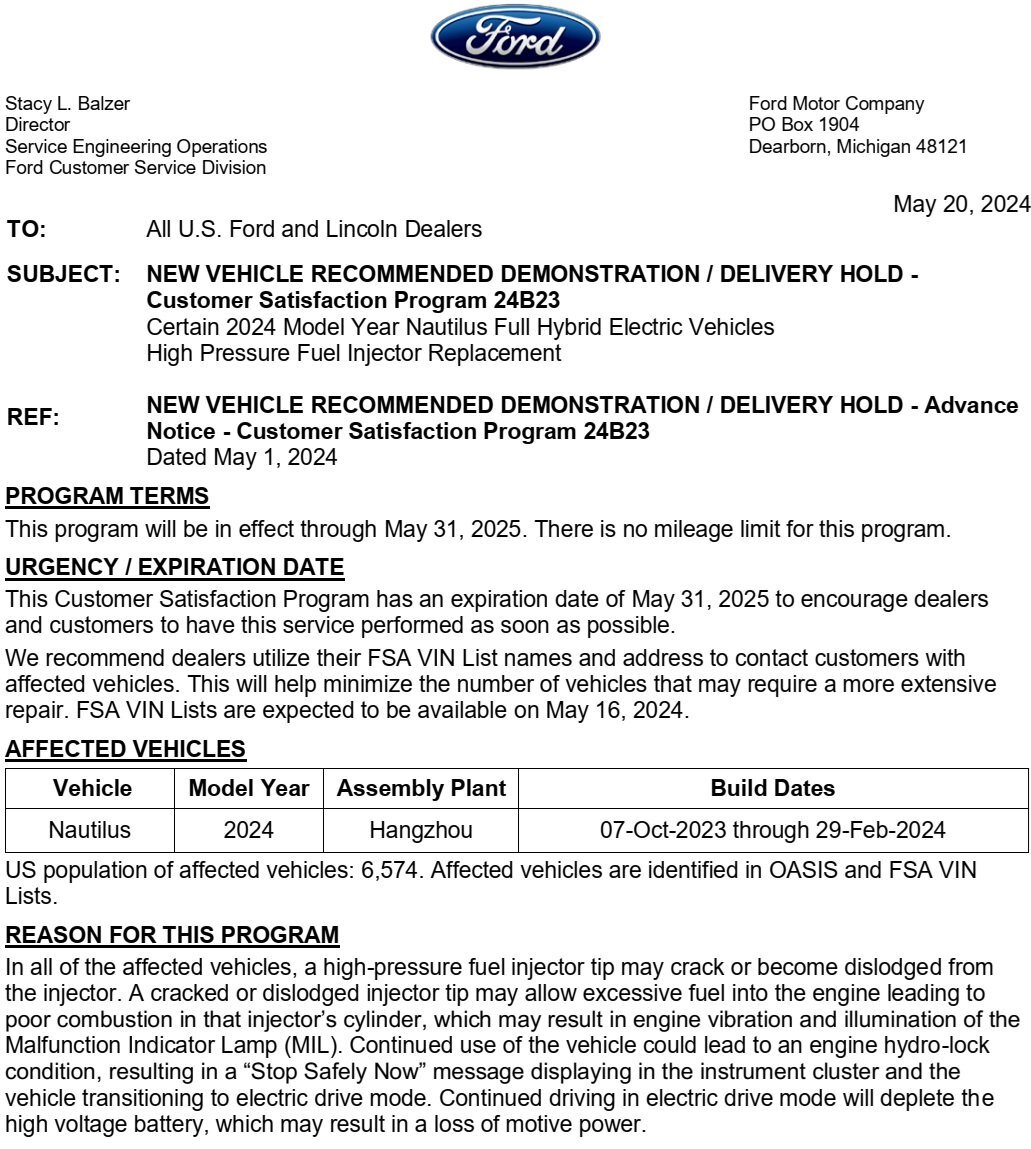

Full Dealer Bulletin follows as a supplement to @markfm's post, but without repeating markfm's above-posted page...
The Full Dealer Bulletin and Technical Instructions were posted to the OASIS server, but have not been announced on the Professional Technician System (PTS) site.
The PTS announcement will likely occur on the morning of May 21, 2024.

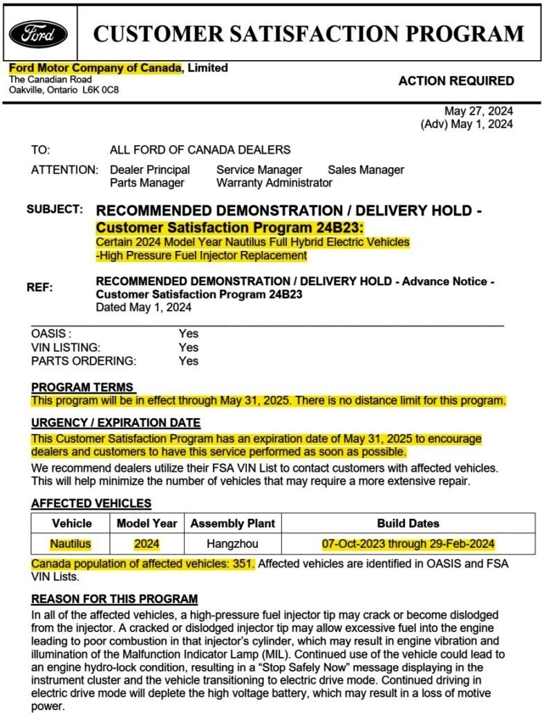

Ford of Canada Full Dealer Bulletin has not yet been released, but it will be added here when it becomes available.
Gratitude to @markfm for his sharing.
05/21/2024 Edit: As expected, from PTS...
No Ford of Canada document or announcement yet, where 351 vehicles are affected.

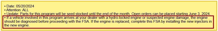

To provide an understanding of the scope of work involved, attached below as a PDF document is the 2024 Nautilus Workshop Manual section referenced in the above-shown CSP 24B23 Technical Instructions...
Direct Injection Fuel Rail - 2.0L EcoBoost - Hybrid (FHEV) - Removal and Installation - 2024 Nautilus Workshop Manual.pdf

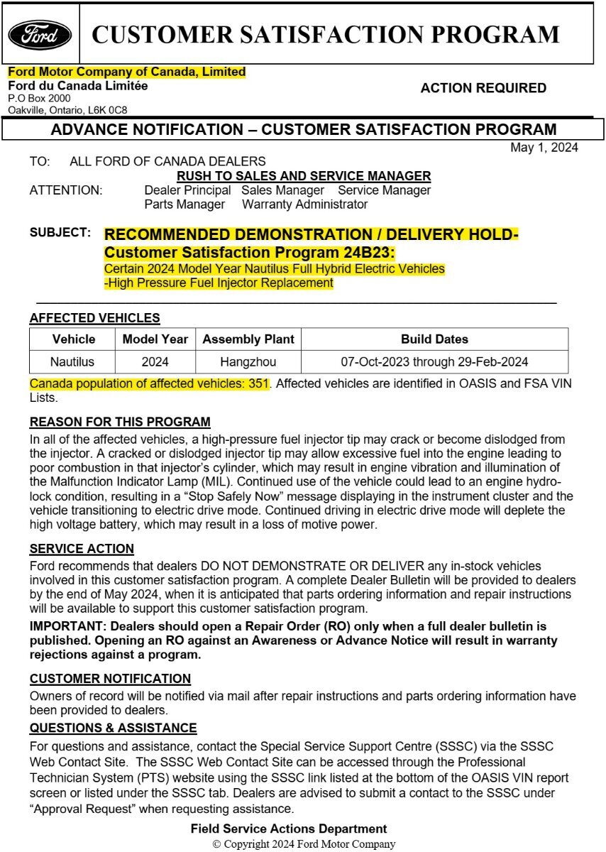

Also, Ford of Canada continues to be in the Advance Notice phase of this Field Service Action.
