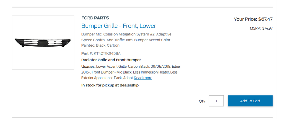

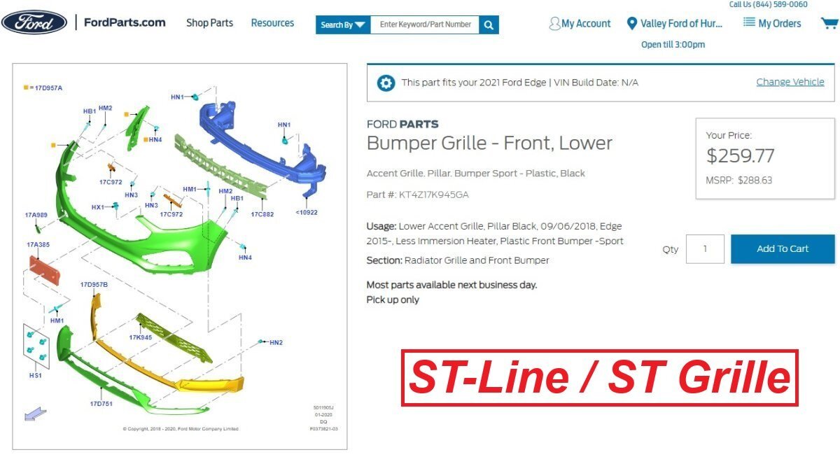

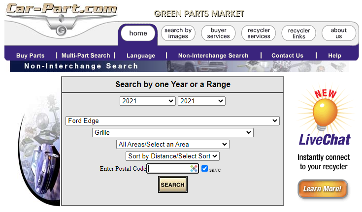

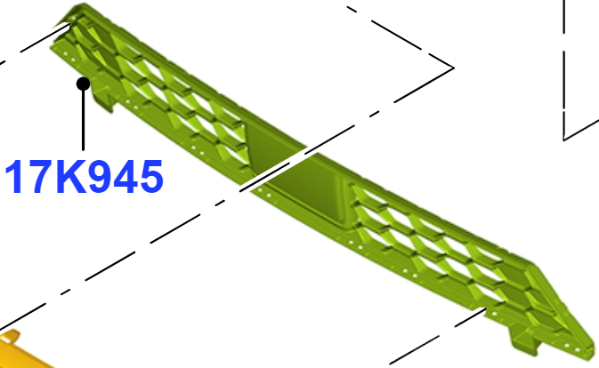

Haz Posted May 25, 2024 Report Share Posted May 25, 2024 (edited) If installing a CCM-protecting lower grille insert interests you, and you prefer not to pay for a fully-new part, Car-Part shows a lower grille available for $140... Image edited to emphasize part's ST-Line/ST fitment.. Relevant section from 2021 Edge Workshop Manual attached below as PDF document... Good luck! Front Bumper Cover - Disassembly and Assembly - 2021 Edge Workshop Manual.pdf Edited May 25, 2024 by Haz 1 Quote Link to comment Share on other sites More sharing options...

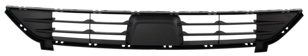

johnmarkp Posted May 25, 2024 Report Share Posted May 25, 2024 Here is the lower grill for the 2019 Edge. I wonder if there is an actual difference? 1 Quote Link to comment Share on other sites More sharing options...
Haz Posted May 25, 2024 Report Share Posted May 25, 2024 (edited) Good catch, @johnmarkp! The FordParts listing I cited is for ST-Line/ST Edge. I should have noticed the word 'Sport' in the listing, and also the honeycomb texture of the Lower Grille illustration as not being the horizontal bar design that @Wubster100 previously shared... The KT4Z-17K945-BA part cited by @johnmarkp matches the Historical Vehicle Bill of Material (HVBoM) using the VIN of a 2021 Edge equipped with Adaptive Cruise. The right new part at a comparably great price. Once again, bravo @johnmarkp! Edited May 25, 2024 by Haz 2 1 Quote Link to comment Share on other sites More sharing options...
