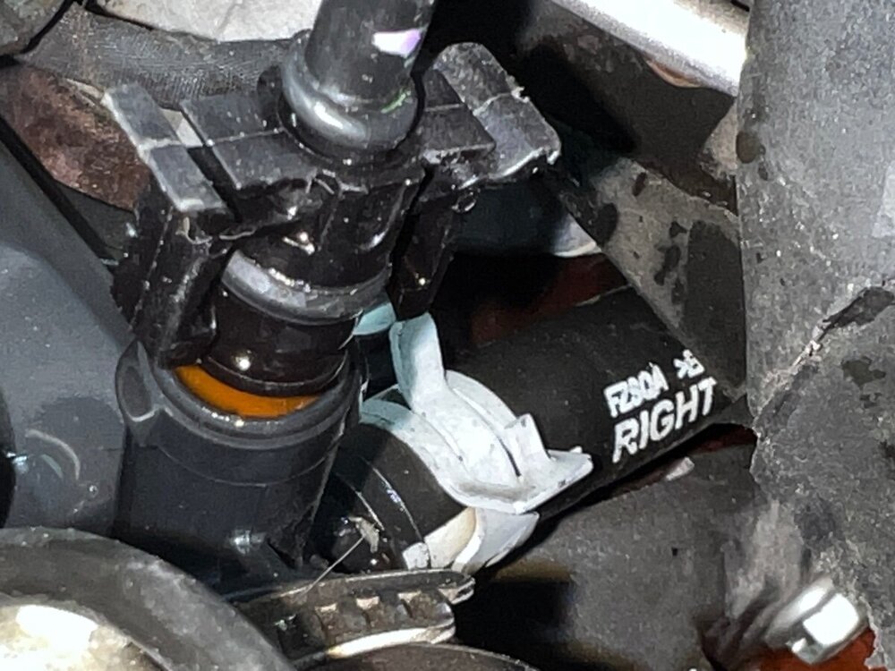

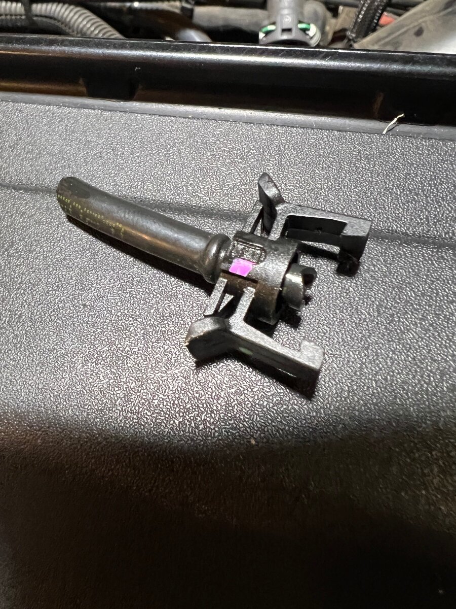

MetalAnon Posted April 13, 2024 Author Report Share Posted April 13, 2024 Thank you for the replies. I had not considered the tensioner, but as I was reaching in to check the belt tension, my arm brushed up against the coolant overflow hose, that plastic line that run across the top of the engine to the stat housing, it snapped like a twig. So my attention turned to that. Found a new line at the local stealer shop and proceeded to start the repair. However, when removing the line from the stat housing, the end of it that interfaces with the hole, broke off inside the port, so now the new line will not seat. Fucking planned obsolescence!!! I have tried everything I can think of to get the piece out. Picks, screw drivers, compressed air, I even tried turning a screw into the damn thing like a puller, to no avail. It is stuck! I really, REALLY want to avoid damaging the thermostat housing for obvious reasons. Thus, my tentative approach to remove the stuck connector end, but I gotta figure this out. Here’s a couple pics… if more pics needed let me know… any ideas? then I will check then tensioner… ffs. Quote Link to comment Share on other sites More sharing options...
