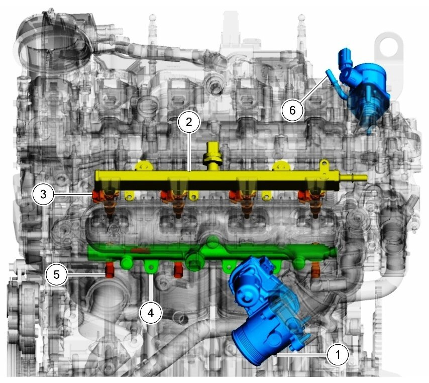

Haz Posted April 29, 2024 Author Report Share Posted April 29, 2024 Ford is restating this message to the Service community, now excluding replacement of Port Fuel Injectors... SSM 52490 2024 Nautilus - 2.0L EcoBoost-Hybrid - Direct Fuel Injector Replacement On 2024 Nautilus 2.0L EcoBoost-Hybrid vehicles, if engine damage or drivability diagnosis leads to replacement of any direct fuel injector assemblies, replace all 4 direct fuel injectors along with other necessary repairs. Refer to Workshop Manual, Section 303-04B Direct Injection Fuel Rail Removal and Installation for the procedure on replacement of the direct injectors. Do not replace the port fuel injectors for this condition. Engineering is currently investigating this concern. Monitor OASIS for further updates. Supplemental illustration from the 2024 Nautilus Workshop Manual... Fuel Charging and Controls - Component Location 2.0L EcoBoost Item Description 1 Throttle body 2 Port injection fuel rail 3 Port injection fuel injectors 4 Direct injection fuel rail 5 Direct injection fuel injectors 6 High-pressure fuel pump 1 Quote Link to comment Share on other sites More sharing options...
