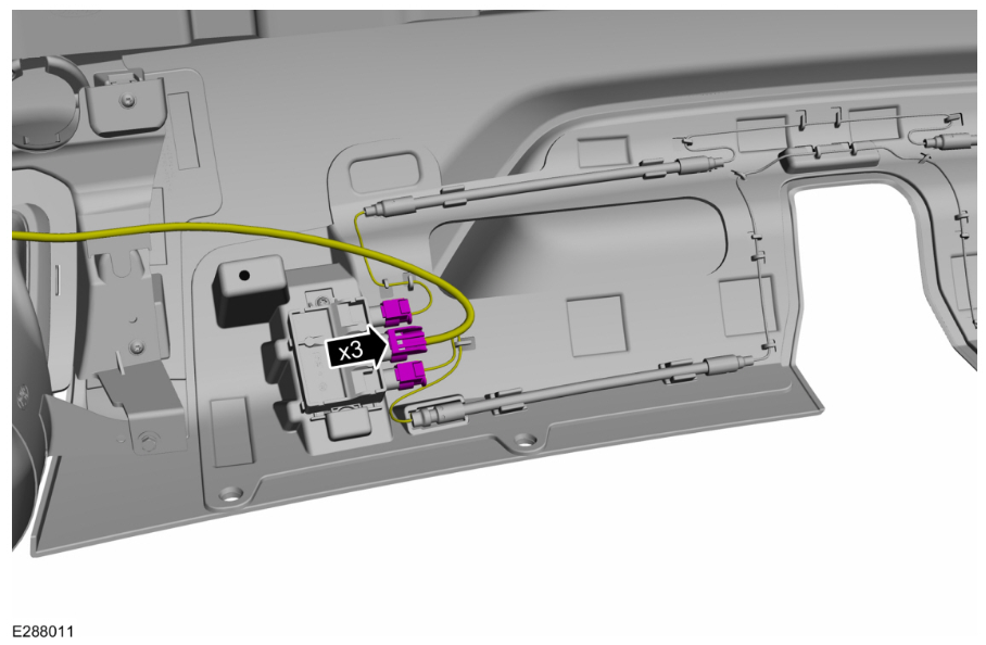

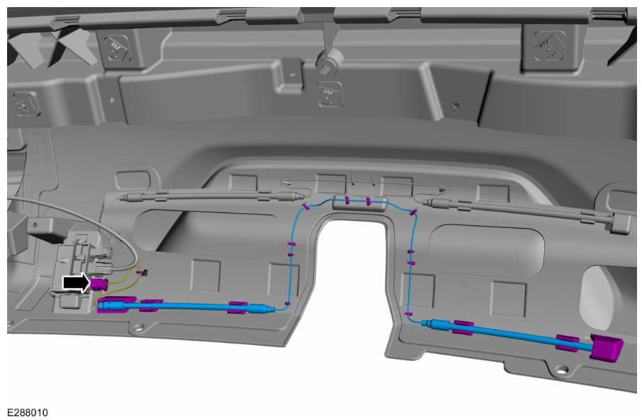

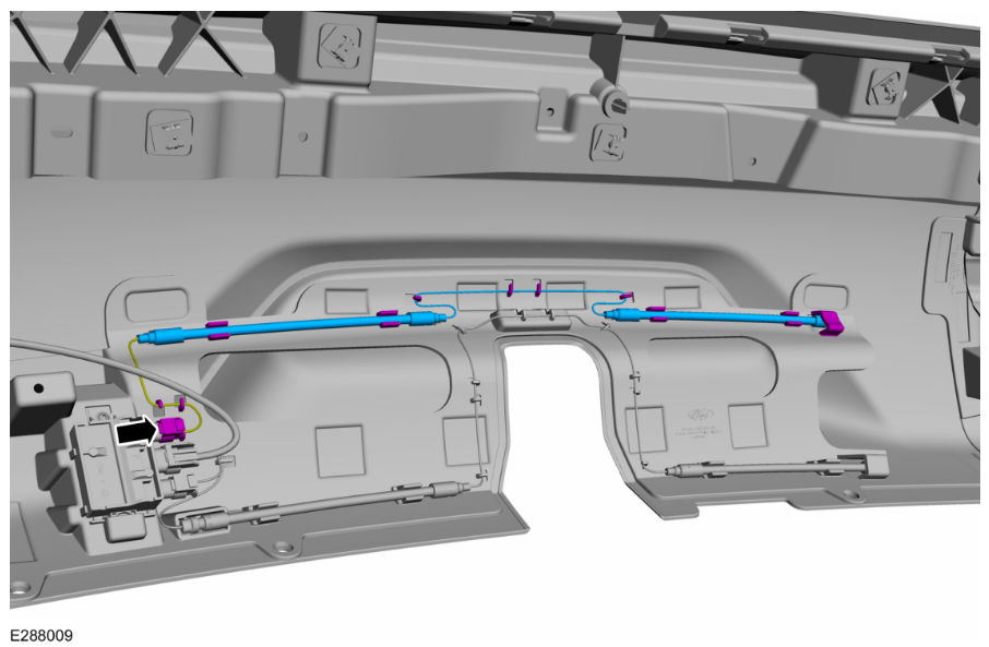

Haz Posted Saturday at 06:45 PM Report Share Posted Saturday at 06:45 PM (edited) Welcome to the Forum @m4rioo! Your Edge's Window Sticker shows the vehicle is Hands-Free equipped... Per @dabangsta's comment, take a look inside your Edge's rear bumper cover for the upper & lower Hands-Free Actuator Sensors... ...and ensure that the Actuator Sensors' electrical connectors are plugged into the Hands-Free Actuator Module... Please Note: The above illustrations are of a tow package-equipped Edge bumper cover. The upper & lower Hands-Free Actuator Sensors on your Edge will be one-piece, and not split ln two-pieces with an interconnecting wire like those shown above. Good luck! 2FMPK4K95PBA29008 - Window Sticker.pdf Edited Saturday at 07:19 PM by Haz 2 Quote Link to comment Share on other sites More sharing options...

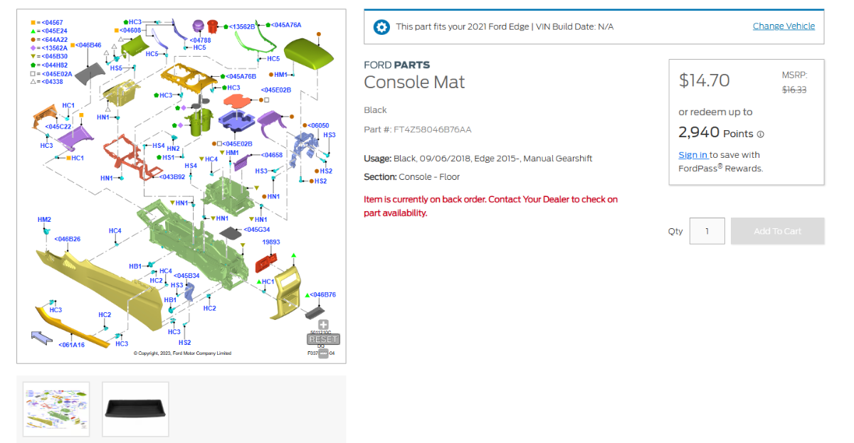

m4rioo Posted Sunday at 05:08 PM Report Share Posted Sunday at 05:08 PM I have one more question. Sorry for posting in this topic. Does anyone know what this part number is? I suspect it's an ashtray. Quote Link to comment Share on other sites More sharing options...
Wubster100 Posted Sunday at 05:13 PM Report Share Posted Sunday at 05:13 PM It is a storage mat. Similar to the rubber inserts inside of the cup holders or the top center of the dashboard. 1 Quote Link to comment Share on other sites More sharing options...
Haz Posted Sunday at 05:52 PM Report Share Posted Sunday at 05:52 PM Image showing installed Console Mat... Good luck! 2 Quote Link to comment Share on other sites More sharing options...
