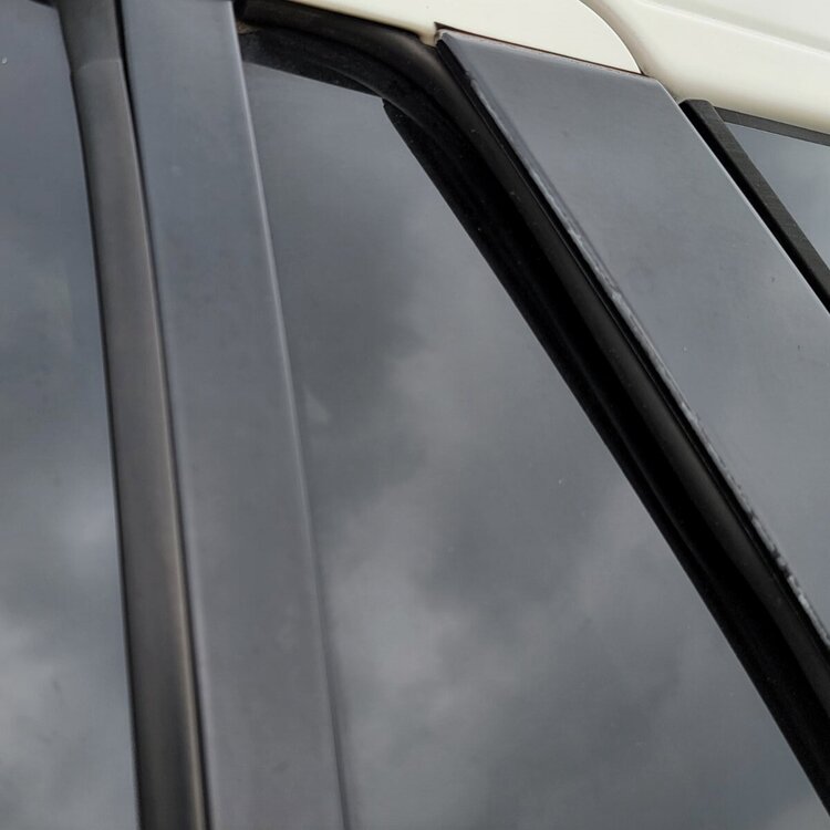

garycrist Posted April 2, 2024 Report Share Posted April 2, 2024 If one loves their Edge long enough and the Sun beats down long enough the rubber gasket starts to rot. Once rotted the air leaks from the cabin and wind noise ensues. If the deteriorated rubber is removed the window will rattle and is not secure. A simple fix is to remove the rubber from the perimeter, starting at the back rear of the passenger's rear wing -glass. Remove the rubber from the bottom to the top, then around the corner, ending at the back top of the window post. Take a piece of 7/32 in vacuum line and stuff it into the channel from the bottom to the top and around the top corner, ending behind the top of the back of the window channel. Quote Link to comment Share on other sites More sharing options...
