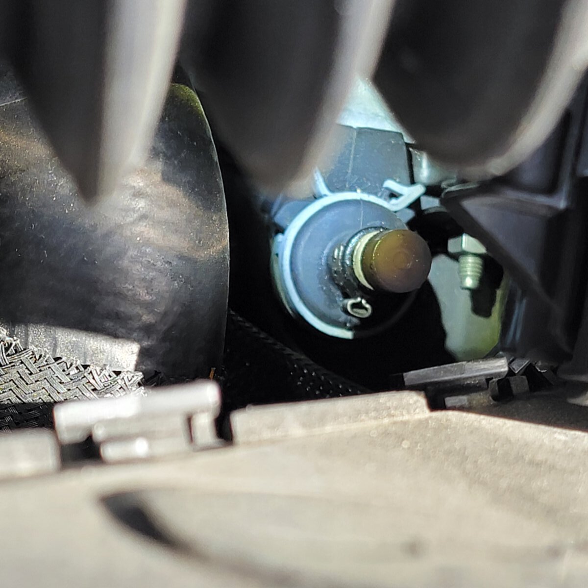

garycrist Posted March 25, 2024 Report Share Posted March 25, 2024 I am getting ready for my 2022 Edge ST AWD 20K service. I was looking for the dip-stick but I can't find it? I believe this is it but, it looks like a vent. Is this it? This is peering down with radiator shield at the bottom, Air-box top right, looking at top of the tranny. Quote Link to comment Share on other sites More sharing options...
dabangsta Posted March 26, 2024 Report Share Posted March 26, 2024 That is the vent and one method to use to fill it (you can also pump it in using the sight level hole). There is no dipstick. There should be some posts on doing the fluid change on the 8F50/8F57, it is similar to the 8F35 that the 2.0 powered 2019 and newer vehicles got. 1 1 Quote Link to comment Share on other sites More sharing options...
