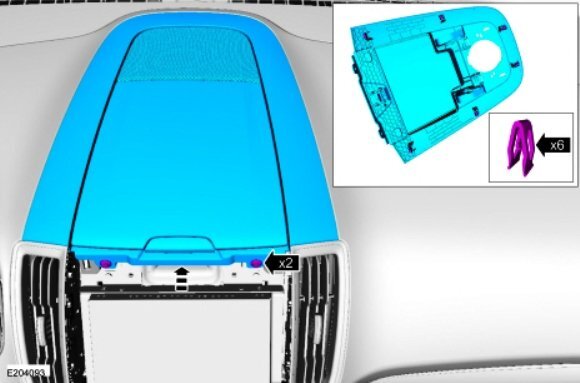

As the Workshop Manual image shows, the removable Upper Instrument Panel Storage Bin is retained by six clips and two screws...

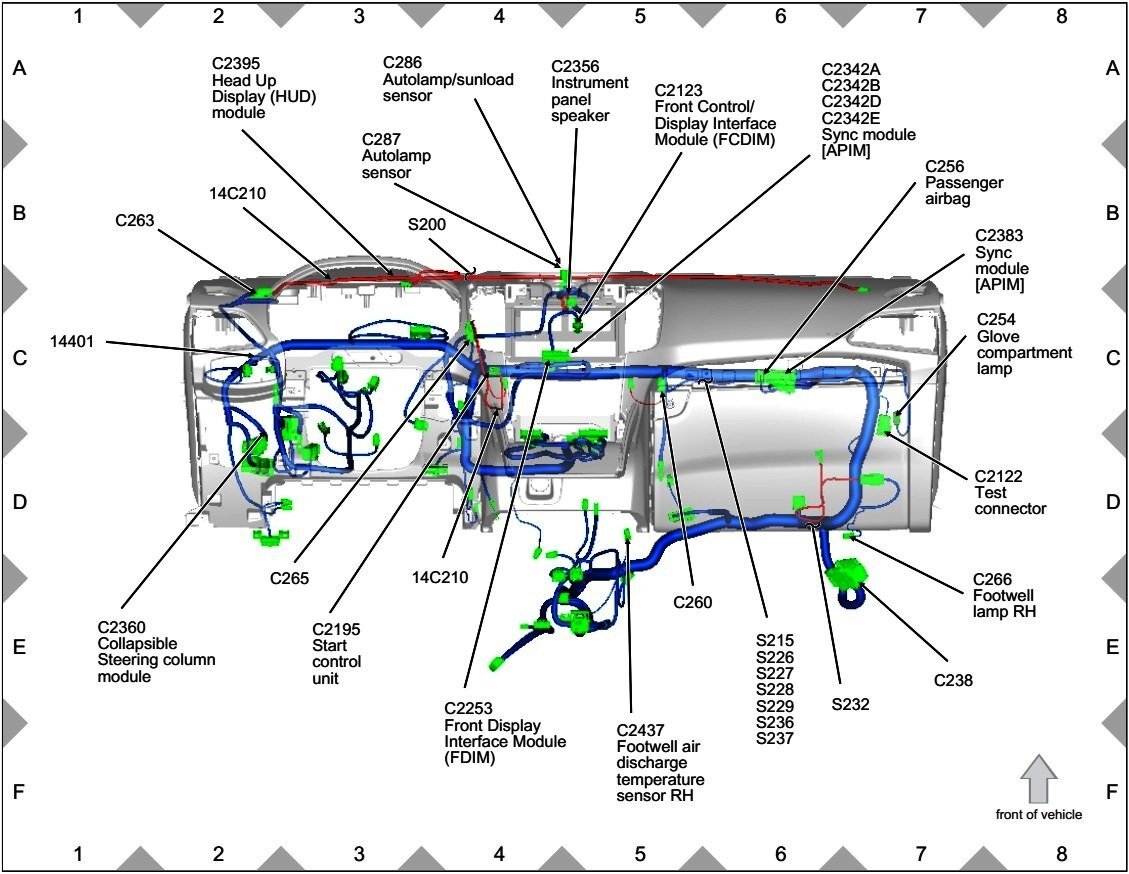

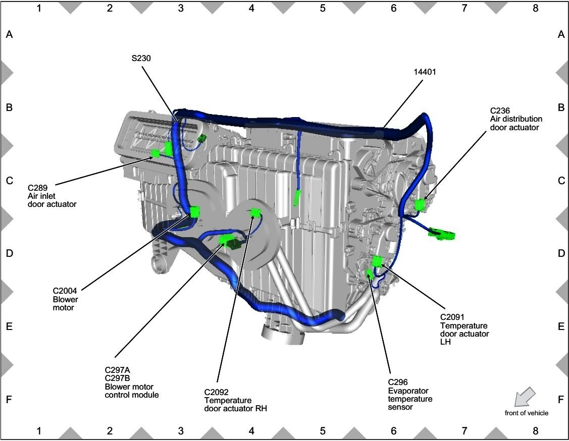

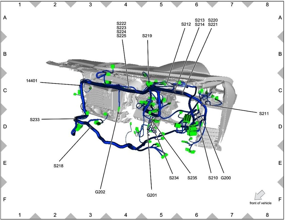

The 2017 Edge Wiring Diagrams offer several views of Instrument Panel and Heater/Evaporator Core Housing harnesses...
InstrumentPanelWiringDiagram-InteriorView-2017Edge.thumb.jpg.cb7d1bf8565fec38cc1842a6865541da.jpg
InstrumentPanelWiringDiagram-FromFirewallView-2017Edge.thumb.jpg.ebe95d015b06d89c2ab2991cc531fa4b.jpg
ClimateControlHousingandWiringDiagram-FirewallView-2017Edge.thumb.jpg.a2b2c2fb9b1ef3d7ac542a36766bbb1a.jpg
Clearances between the floor of the Upper Instrument Panel Storage Bin and the various wiring harnesses & Heater/Evaporator Core Housing are unclear.
Removing the Storage Bin involves disassembling several trim pieces and center stack components using procedures described in the below-attached documents...

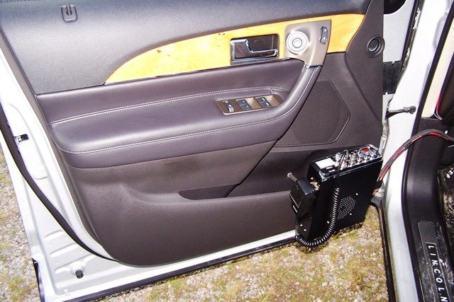

When faced with where to place a Galaxy CB radio in our previous MKX, I elected to mount the bracket on the driver's door panel storage bin...
Outboard leg room was diminished a bit, but the radio's controls were visible & usable when driving, and being black-on-black, the radio wasn't obvious when looking in from outside the vehicle.
