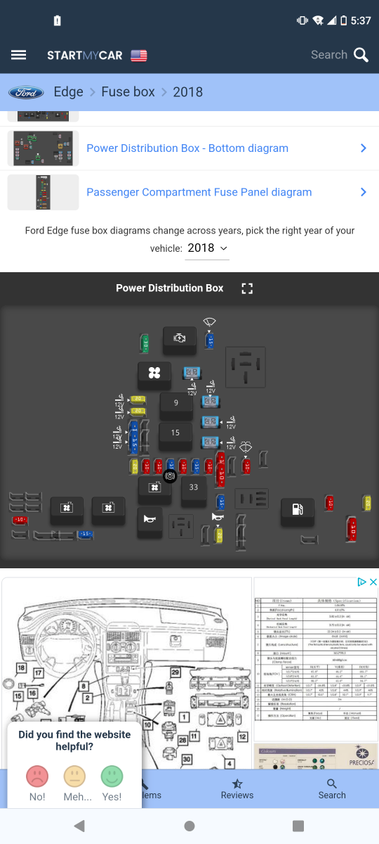

Rayslyn Posted March 19, 2024 Author Report Share Posted March 19, 2024 Update. Checked both fuses and they are good. Any other ideas? Quote Link to comment Share on other sites More sharing options...
