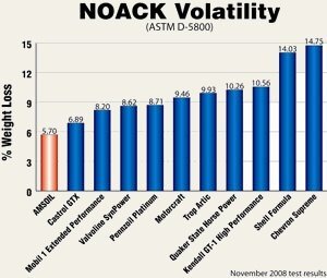

Cerberus Posted March 10, 2024 Report Share Posted March 10, 2024 (edited) On 3/10/2024 at 9:43 PM, garycrist said: Anything one can do to eliminate carbon build-up in the intake path is worth GOLD! Depending on the fuel quality from the distributor and the additive package that are blended in, either at the point of sale (Costco) or the source, build-up can be mitigated depending on the additive package. Ford specifies TT type fuel which has P.E.A. detergent, Shell w/ Nitrogen, Techron Costco to name a few. Most have P.B.A. but, it will not get rid of the high temp gunk on the valves etc. like P.E.A. The catch can is cheap insurance for a KNOWN PROBLEM. But hey, like the "Fram Man" should have said "You can pay me now and you can pay me later". How much later depends on you. For the "Tech Wienies" who want to know why, here we go. 5W-30 motor oil is thin and gets thinner as it heats. I do not care for the 30 part as it only goes to the "holding ability" to keep parts apart. With thinner ring packs, short skirts (I like short skirts), thin oil, high R.P.M. and turbo boost will produce tons of blow-by. It consists of misted oil whipped up in the crank case by the crankshaft spinning and leakage of combustion products and coked oil that was burned about the 2nd. ring on down the piston skirt. Remember those "short skirts"? Well at high R.P.M. they allow "piston rock" where the piston is not square to the bore. With the wider gap in the rings to prevent them butting together and piston rock, excess "blow-by" is produced ! In our turbo engines that gap has to be wider than a N.A. engine. That gap provides extra "blow-by" that we are trying to cut down with the catch can. Expand fuel cleaners etc are of no use for valve cleaning on direct injected engines.. unless there are supplemental port injectors.. because the fuel never gets into the induction plenum / ports if you want to get in to the real tech weenie level, you need to understand that different oils of THE SAME VISCOSITY, will entirely different volatility rates, and this is the primary part of the oil caught by the catch can system. https://www.bestsynthetic.com/volatility.shtml A full synthetic of high quality will resist coking more than some garbage blended synthetic, which will minimize coking on rings, intake valves etc and the catch can does nothing about blow by, it just collects oil and water (ETC) before it can get to the valves. The blow by still happens. Edited March 10, 2024 by Cerberus Clarity 2 1 Quote Link to comment Share on other sites More sharing options...
garycrist Posted March 10, 2024 Report Share Posted March 10, 2024 Volatility rates of oils was fun back in the 80's. When the valve cover started leaking on client's cars. 1st. thing I would ask was if it was Pennzoil or Quaker State. They were paraffin based and left the covers filled with crud! I've stuck with synthetics since the 70's. Ashless like AeroShell was the same thing in the Valvoline Racing but with different additive packages with Valvoline having more ZDP. AeroShell was GREAT for oil burners too! I still add a quart or two of Valvoline Racing (high ZDP) to my oil changes to my 08 Edge with 210,00 miles. That seemed to quiet down the cam phasers. With all of the metal pieces crushed together to make the cams move, i looked at them just like flat tappet cam contact that need extra protection and the ZDP. 1 Quote Link to comment Share on other sites More sharing options...
