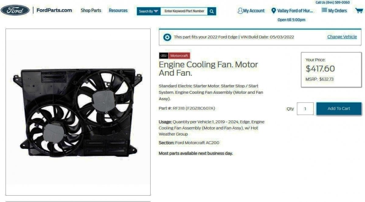

dabangsta Posted January 30, 2024 Report Share Posted January 30, 2024 There is also one that is listed as a few things, w hot weather group (available in some countries), and with towing (which the ST has) https://parts.ford.com/shop/en/us/climate-control/ac-repair-parts/engine-cooling-fan-motor-and-fan-p-rf318?pdp=y which is part number and engineering number Part #: RF318 (F2GZ8C607A) (A suffix versus E). Since they all have towing, I guess that is the standard ST and not the brushless one? Or maybe it is? Quote Link to comment Share on other sites More sharing options...

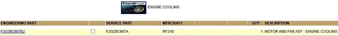

Haz Posted February 1, 2024 Report Share Posted February 1, 2024 To supplement dabangsta's findings, I pulled Historical Vehicle Bill of Material (HVBoM) reports on 2022 & 2024 ST Performance Brake Package Edges and both confirm the Ford and Motorcraft part numbers... Similarly, those same part numbers are reflected on the FordParts website in reply to the same 2022 & 2024 ST Performance Brake Package Edge VINs... Document download links> Cooling Fan Motor and Shroud - Removal and Installation - 2.7L EcoBoost - 2022-2024 Edge Workshop Manual.pdf Cooling Module - Removal and Installation - 2.7L EcoBoost - 2022-2024 Edge Workshop Manual.pdf Good luck! 2 Quote Link to comment Share on other sites More sharing options...
