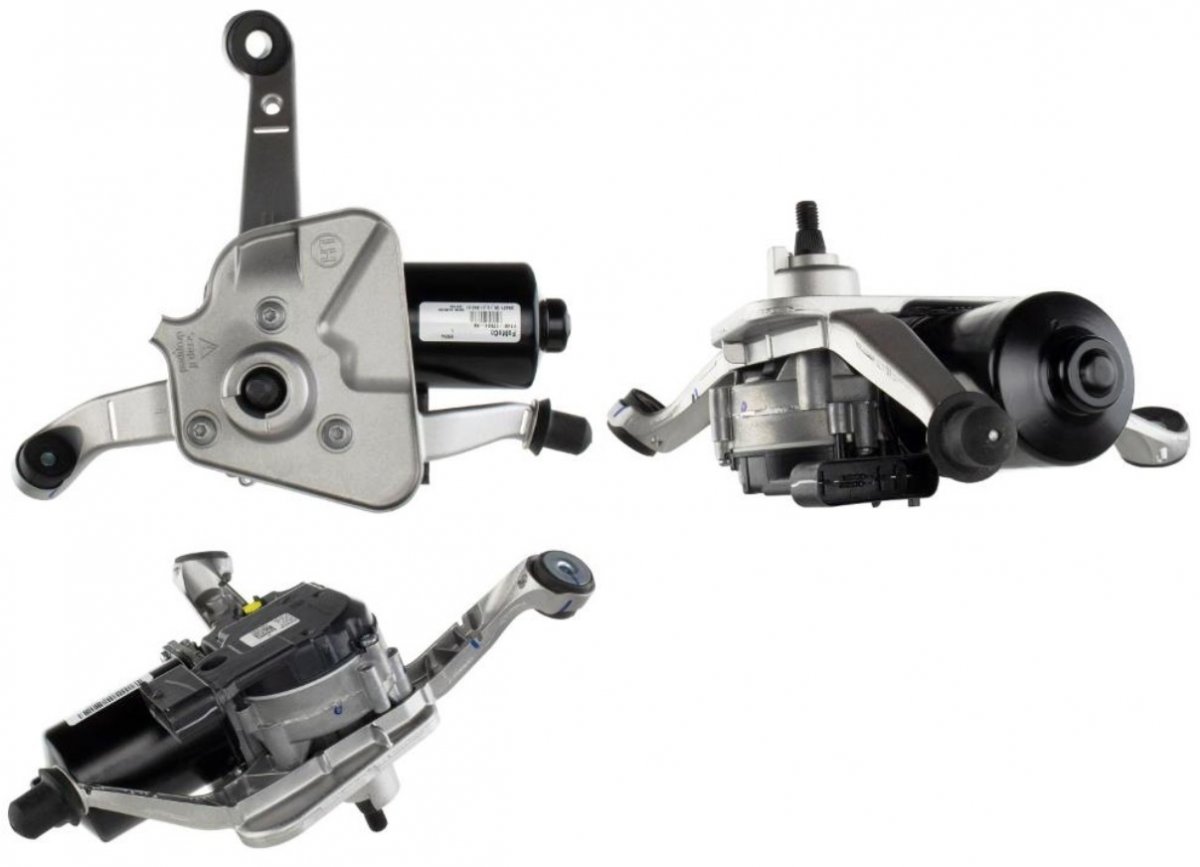

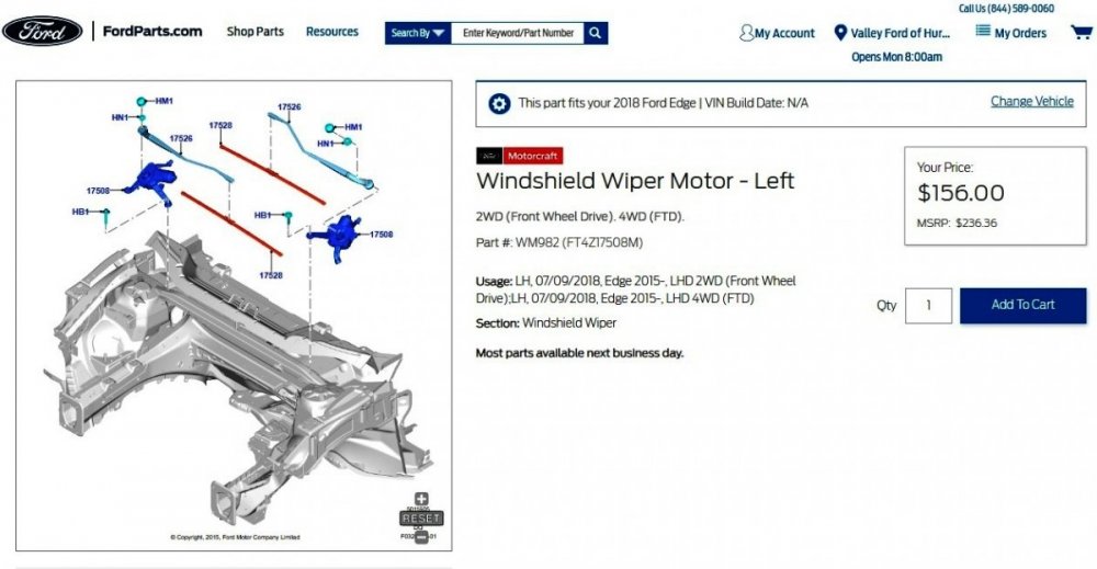

Haz Posted January 8, 2024 Report Share Posted January 8, 2024 Welcome to the Forum, phillieeagle ! Having your Edge Sport scanned for Diagnostic Trouble Codes (DTCs) may reveal a cause of the left hand wiper motor symptoms. I did find this Special Service Message (SSM) describing intermittent wiper motor operation due to snow and ice blockage -- clearly not your Edge's issue, though repeated resistance to movement can lead to wiper motor replacement... SSM 48094 2015-2019 Edge Vehicles - Build On Or Before 5-Nov-2018 - Wipers Intermittent Operation Issues In Snow/Ice Conditions Some 2015-2019 Edge vehicles build on or before 5-Nov-2018 may exhibit snow and/or ice accumulation below the wiper blade park position, causing the wipers to have intermittent operational issues. If normal diagnostics do not result in a root cause determination, replace the driver’s side wiper motor with updated service part FT4Z-17508-H, and make sure the customer is advised to keep the cowl area clean of ice and snow. Refer to Workshop Manual (WSM), Section 501-16 and applicable labor operations in Section 11 of the Service Labor Time Standards (SLTS) Manual. Diagnostic and repair procedures are provided in this, and immediately following Forum posts, due to Forum attachment limitations... Document download links> Wipers and Washers - System Operation and Component Description - 2018 Edge Workshop Manual.pdf Wipers and Washers - Diagnosis and Testing - 2018 Edge Workshop Manual.pdf DIAGNOSTIC PINPOINT TEST G - THE WINDSHIELD WIPERS DO NOT PARK AT THE CORRECT POSITION - 2018 Edge Workshop Manual.pdf Windshield Wiper Pivot Arm - Removal and Installation - 2018 Edge Workshop Manual.pdf Windshield Wiper Motor - Wiring Diagram - 2018 Edge.pdf Cowl Panel Grille - Removal and Installation - 2018 Edge Workshop Manual.pdf Cowl Panel - Removal and Installation - 2018 Edge Workshop Manual.pdf Windshield Wiper Motor - Removal and Installation - 2018 Edge Workshop Manual.pdf 2 Quote Link to comment Share on other sites More sharing options...
