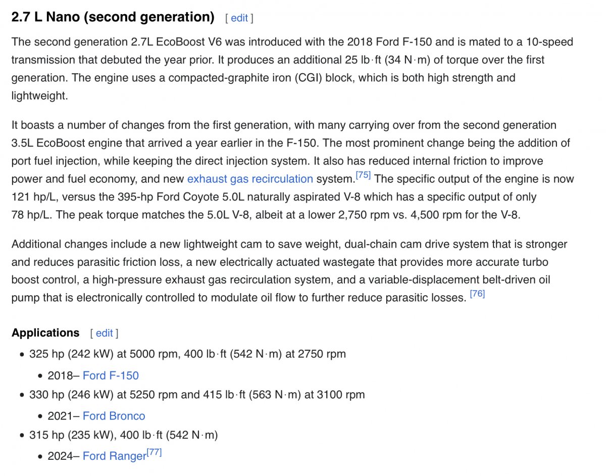

Nick Halstead Posted January 11, 2024 Report Share Posted January 11, 2024 10 hours ago, STBEAST said: I'm not 100% sure but it looks to have the 2.7 Nano engine which has port direct fuel injection (2 injectors per cylinder). I'm trying to verify. Yes its a Nano engine, no its not the GEN 2. The 2.7 in your 2024 is same as the one in my 2015 Quote Link to comment Share on other sites More sharing options...
Cerberus Posted January 12, 2024 Author Report Share Posted January 12, 2024 10 hours ago, Nick Halstead said: Yes its a Nano engine, no its not the GEN 2. The 2.7 in your 2024 is same as the one in my 2015 Umm... Based on what? I was under the impression that after 2018 the Gen 2 2.7 was being used throughout the brand. This is a primary sticking point for me because the Gen2 engine uses a wet (oil exposed) belt to drive the oil pump, which gives me serious concerns about the reliability of the oil system. Quote Link to comment Share on other sites More sharing options...
Nick Halstead Posted January 12, 2024 Report Share Posted January 12, 2024 11 minutes ago, Cerberus said: Umm... Based on what? I was under the impression that after 2018 the Gen 2 2.7 was being used throughout the brand. This is a primary sticking point for me because the Gen2 engine uses a wet (oil exposed) belt to drive the oil pump, which gives me serious concerns about the reliability of the oil system. The Gen 2 is only in rwd platforms. Transverse applications did not receive the GEN2 Nano, only F150, Bronco and Ranger 3 Quote Link to comment Share on other sites More sharing options...
JoeVic Posted January 12, 2024 Report Share Posted January 12, 2024 39 minutes ago, Cerberus said: Umm... Based on what? I was under the impression that after 2018 the Gen 2 2.7 was being used throughout the brand. This is a primary sticking point for me because the Gen2 engine uses a wet (oil exposed) belt to drive the oil pump, which gives me serious concerns about the reliability of the oil system. I have a 19 ST. I am more concerned with the carbon build up on the valves due to the Direct Injection than the wet belt drive oil pump. Nick Halstead is correct the 2.7 in the Edge is not the 2nd Gen with dual injection. Quote Link to comment Share on other sites More sharing options...
STBEAST Posted January 12, 2024 Report Share Posted January 12, 2024 (edited) Ok, according to the research I just did, the Gen 2 came out in 2018 and has the dual fuel injectors (one to keep the intake valve clean). The Gen 2 is also known as the Nano and is the same engine. What I don't know is what year they started using it in the Edge St. I'm guessing 2019? Edited January 12, 2024 by STBEAST Quote Link to comment Share on other sites More sharing options...
Cerberus Posted January 12, 2024 Author Report Share Posted January 12, 2024 5 hours ago, Nick Halstead said: The Gen 2 is only in rwd platforms. Transverse applications did not receive the GEN2 Nano, only F150, Bronco and Ranger This is contradicting what I'd been led to believe. Now I want to visit a dealership and see if I can visually verify that it is only direct injected. Thank you for the information, this shakes up the whole equation. 1 Quote Link to comment Share on other sites More sharing options...
Cerberus Posted January 12, 2024 Author Report Share Posted January 12, 2024 5 hours ago, JoeVic said: I have a 19 ST. I am more concerned with the carbon build up on the valves due to the Direct Injection than the wet belt drive oil pump. Nick Halstead is correct the 2.7 in the Edge is not the 2nd Gen with dual injection. I'd by far prefer carbon build up on valves over a wet belt driven oil pump. Carbon on valves is slow, progressive, tolerable, avoidable and relatively easily fixable, whereas oil pump drive failure is sudden, and terminal. Thanks for the personal experience Quote Link to comment Share on other sites More sharing options...
omar302 Posted January 12, 2024 Report Share Posted January 12, 2024 4 hours ago, STBEAST said: Ok, according to the research I just did, the Gen 2 came out in 2018 and has the dual fuel injectors (one to keep the intake valve clean). The Gen 2 is also known as the Nano and is the same engine. What I don't know is what year they started using it in the Edge St. I'm guessing 2019? The intake manifold part number (this on Tasca) is the same for all 2015+ Ford Edge 2.7 models, however, it is only for 2015-2017 F-150 models. The intake manifold would have been changed in case port injection was added to the 2019+ Edge. In my opinion, this is a confirmation that the Edge/Nautilus did NOT get the 2nd generation Nano. 2 1 Quote Link to comment Share on other sites More sharing options...
Fingernip Posted January 12, 2024 Report Share Posted January 12, 2024 8 hours ago, STBEAST said: Ok, according to the research I just did, the Gen 2 came out in 2018 and has the dual fuel injectors (one to keep the intake valve clean). The Gen 2 is also known as the Nano and is the same engine. What I don't know is what year they started using it in the Edge St. I'm guessing 2019? They use it in the F150 but not the edge. The 1st gen is also called nano but the 2nd gen is only in the F150, bronco and ranger. Quote Link to comment Share on other sites More sharing options...
handfiler Posted January 12, 2024 Report Share Posted January 12, 2024 (edited) Why is it so difficult to comprehend factual information? All Edge/Nautilus have the Gen 1, 2.7. The newer ones have both the intake valve fouling GDI and the rubber band driven oil pump. With proper maintenance they will run forever. I have one and I'm not losing any sleep over it. Edited January 12, 2024 by handfiler 1 Quote Link to comment Share on other sites More sharing options...

Cerberus Posted January 13, 2024 Author Report Share Posted January 13, 2024 12 hours ago, akirby said: Right, but Wikipedia is not always accurate. That's often my first stop for information, but rarely my last stop on the search for complete and accurate information 1 Quote Link to comment Share on other sites More sharing options...
