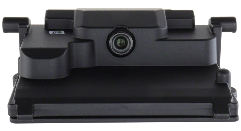

potage Posted January 3, 2024 Report Share Posted January 3, 2024 Hey, do any of you guys know the pinout for the lane keep assist camera for a 2019 ford edge this is the part number KT4T19H406CE thanks! Quote Link to comment Share on other sites More sharing options...

potage Posted January 3, 2024 Author Report Share Posted January 3, 2024 Thanks a a lot! it turned out to be the same pinout as the maverick, the wiring has a different color coding, the system operation module is reallyy nice! Quote Link to comment Share on other sites More sharing options...

potage Posted January 15, 2024 Author Report Share Posted January 15, 2024 I can confirm that the pin out is the same as the ford maverick, wiring color code is different, I managed to connect and see the module in forscan Quote Link to comment Share on other sites More sharing options...
