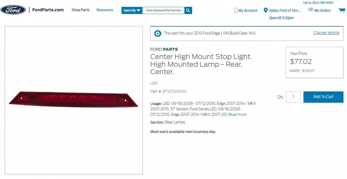

UnholyDjMiku Posted December 29, 2023 Report Share Posted December 29, 2023 Hello, is the 3rd brake light up in the spoiler LED or traditional halogen? Was doing a basic inspection of my car after doing maintenance and saw a few lights in my 3rd brake light are out. From what I can tell, its a sealed unit with an LED chipset inside. However when I look it up online, it comes up with an actual halogen bulb that matches the parking/plate/house lights. There's my conflict, Thanks yall, cheers Quote Link to comment Share on other sites More sharing options...

Haz Posted December 29, 2023 Report Share Posted December 29, 2023 The 2007-2010 Edge wiring diagrams depict the lamps in the High Mounted Stop Lamp assembly as being conventional filament bulbs, while the 2011 Edge wiring diagram depicts LEDs. The currently offered Service replacement High Mounted Stop Lamp assembly is now LED for 2007-2014 Edge... Link to this FordParts web page Document download links> High Mounted Stop Lamp Wiring Diagram - 2007-2010 Edge.pdf High Mounted Stop Lamp Wiring Diagram - 2011-2014 Edge.pdf Wiring Diagram Symbols - Edge.pdf High Mounted Stop Lamp - Connector C904 Details - 2007-2014 Edge.pdf High Mounted Stop Lamp - Connector C904 Location - 2007-2014 Edge.pdf Good luck! 1 Quote Link to comment Share on other sites More sharing options...
