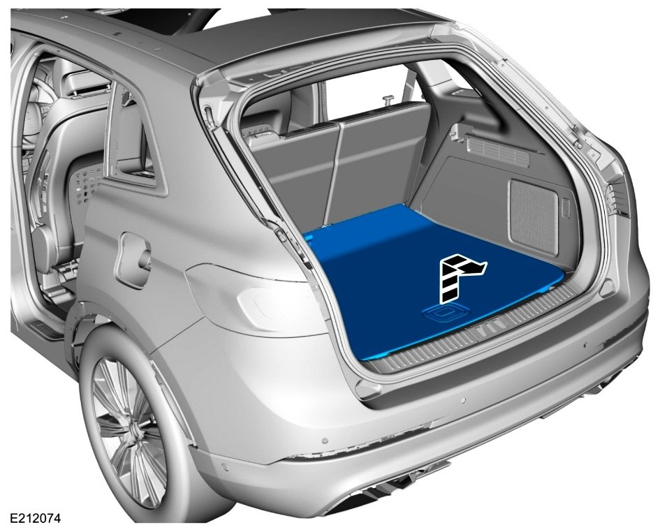

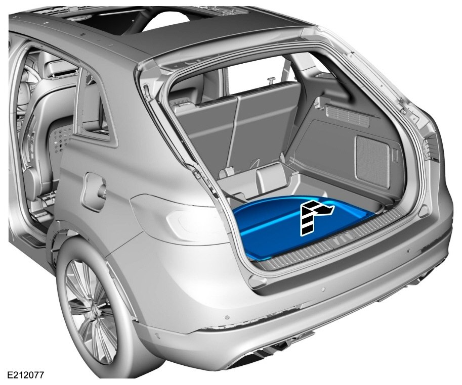

Haz Posted December 10, 2023 Report Share Posted December 10, 2023 Have you tried removing the panel(s) you describe and taking a test drive, in order to confirm or eliminate it as the source of the noise/vibration/harshness? From the 2016 Edge Workshop Manual... Remove the load compartment floor cover. If equipped: Remove the spare tire cover. Good luck! 1 Quote Link to comment Share on other sites More sharing options...
oskar27 Posted December 10, 2023 Author Report Share Posted December 10, 2023 Yes It is the panel in your first picture which feels "loose" in my car. I remember when I used to lift that panel to access the storage spaces under it, after it used to kind of "fit or locked" somewhere / somehow. Now it sit loose and yesterday when driving I noticed the end of it by the rear gate was flopping up/dn and making the rattling sound Last night I play with it and now somehow "feels" its stuck somewhere. Will test drive it today or tomorrow and post back. If noise is still there I will test drive without that panel. Thanks for your time 1 Quote Link to comment Share on other sites More sharing options...

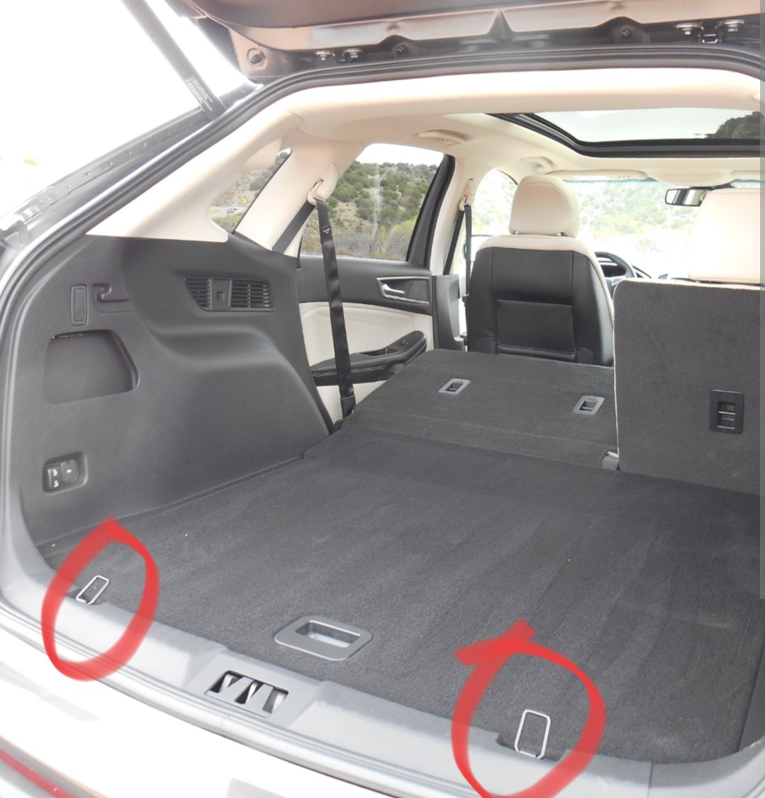

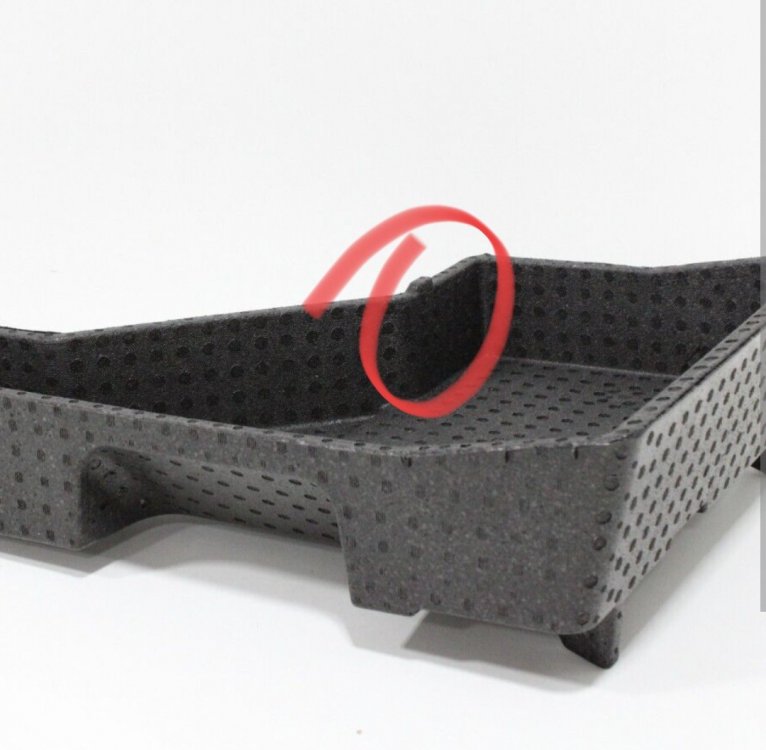

omar302 Posted December 10, 2023 Report Share Posted December 10, 2023 (edited) There are 2 tie down hooks (loops), make sure they are not under the loose panel, otherwise the panel will not fully seat. Also, the storage bins have raised nibs that go in to slots under the panel. So if they are not aligned correctly, the panel would also not seat correctly. Edited December 11, 2023 by omar302 Spelling 1 1 Quote Link to comment Share on other sites More sharing options...
oskar27 Posted December 10, 2023 Author Report Share Posted December 10, 2023 Many thanks for the tips, I will check them out. Freezing rain here so test drive will take place perhaps tomorrow 1 Quote Link to comment Share on other sites More sharing options...

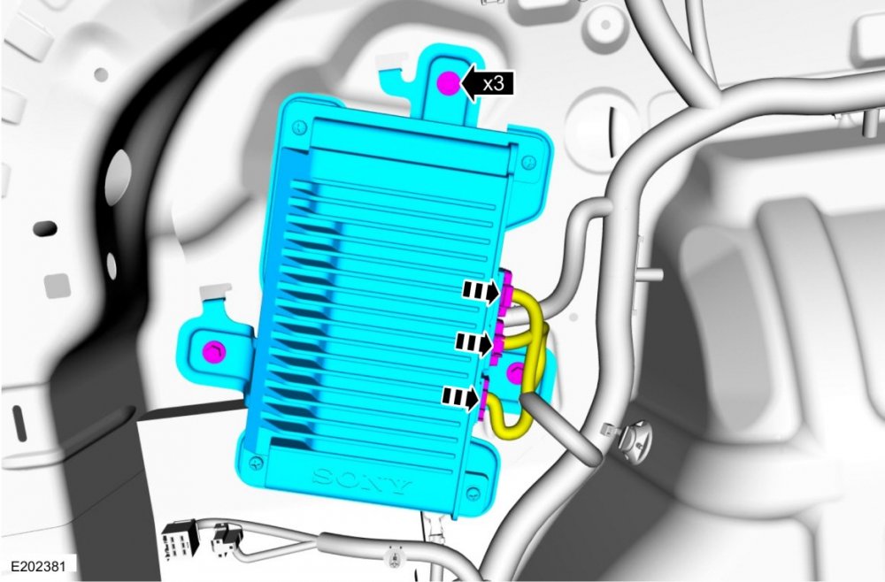

Haz Posted December 17, 2023 Report Share Posted December 17, 2023 If your Edge is equipped with the Sony Audio System, the Sony Audio Digital Signal Processing (DSP) Module is mounted immediately behind the Loadspace Trim Panel that you have marked in your photo... Good luck! 2 Quote Link to comment Share on other sites More sharing options...
oskar27 Posted December 17, 2023 Author Report Share Posted December 17, 2023 Thank again Haz, I do have the Sony and that makes me believe that module in banking inside the cavity. I will check it tonight or tomorrow and report back. 1 Quote Link to comment Share on other sites More sharing options...
