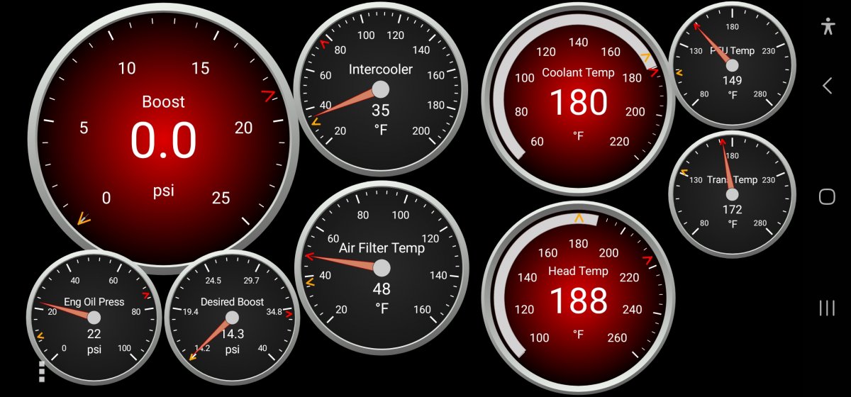

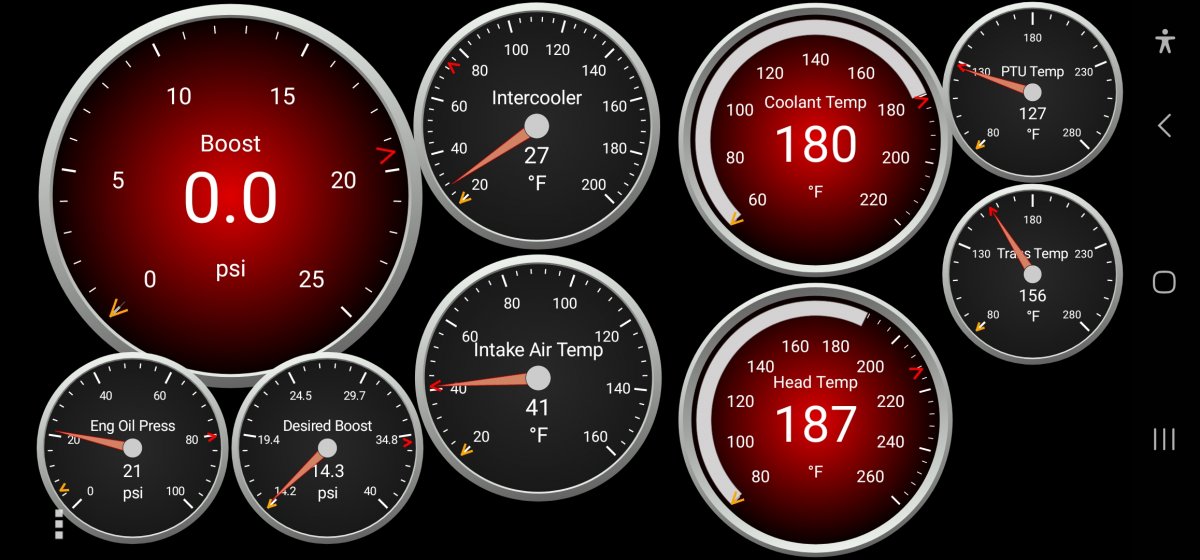

Cerberus Posted November 29, 2023 Author Report Share Posted November 29, 2023 Granted this happened while coming to a stop or turning/ accelerating from a stop, but that yellow arrow head at around 7psi oil pressure is not something I can easily ignore. I dont think an oil pressure sensor is to blame. Quote Link to comment Share on other sites More sharing options...
dabangsta Posted November 29, 2023 Report Share Posted November 29, 2023 Since everything else shows the minimum at the low end of the scale, that 7 psi wasn't from initial startup? Can it be reset to not show initial value? I wonder how it is calculated. When I was adding PIDs to Torque the oil pressure one was actually percentage. So most people change the formula to use 80 psi as 100% (so they take the percentage of 80 psi and display that as the pressure) which seems to be what is done here. Quote Link to comment Share on other sites More sharing options...
Cerberus Posted November 29, 2023 Author Report Share Posted November 29, 2023 8 hours ago, dabangsta said: Since everything else shows the minimum at the low end of the scale, that 7 psi wasn't from initial startup? Can it be reset to not show initial value? I wonder how it is calculated. When I was adding PIDs to Torque the oil pressure one was actually percentage. So most people change the formula to use 80 psi as 100% (so they take the percentage of 80 psi and display that as the pressure) which seems to be what is done here. Everything else shows zero because I did not reset the min/max on them. I did reset the min/max on the oil press after startup. Cold idle, it's around 27psi and solid. At temperature, it flickers as I described before. This value is not a percentage. Quote Link to comment Share on other sites More sharing options...

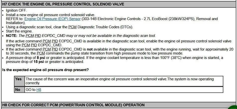

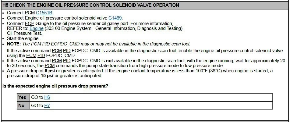

Haz Posted December 10, 2023 Report Share Posted December 10, 2023 (edited) Perhaps your Workshop Manual extract is from prior to October 15, 2019, when that 2015 Specifications page was revised... Oil Pressure NOTE: The following oil pressure readings are acquired using a scan tool and monitoring the EOP_PRESS PID. Item Specification Reading 1: Minimum average oil pressure @ 2,000 rpm after 15 secs with engine at normal operating temperature and transmission in Park 21 psi (144.8 kPa) Reading 2: Minimum average oil pressure @ 2,000 rpm after 15 secs with engine at normal operating temperature and transmission in Park (Oil Pressure Control Solenoid connector disconnected) Reading 1 value plus 8 psi (55.1 kPa) Your supposition on the Oil Pressure Control Solenoid affect is confirmed by Steps 5 & 7 of Electronic Engine Controls diagnostic Pinpoint Test H... Document download link> Oil Pressure Control Solenoid Removal and Installation - 2015 Edge Workshop Manual, Revised 01-09-2015.pdf (consistent with 2016 Edge Workshop Manual) Good luck! Edit: I neglected to include... DTC Fault Trigger Condition-PCM DTC Description Fault Trigger Conditions P06DA Engine Oil Pressure Control Circuit/Open Sets when the PCM detects an open on the engine oil pressure control solenoid valve circuit. P06DB Engine Oil Pressure Control Circuit Low Sets when the PCM detects a short to ground on the engine oil pressure control solenoid valve circuit. P06DC Engine Oil Pressure Control Circuit High Sets when the PCM detects a short to voltage on the engine oil pressure control solenoid valve circuit. P06DD Engine Oil Pressure Control Circuit Performance/Stuck Off Sets when the PCM detects the engine oil pressure control solenoid valve is stuck. Possible Sources Engine oil pressure control solenoid valve PCM Wiring, terminals or connectors Edited December 10, 2023 by Haz 3 Quote Link to comment Share on other sites More sharing options...
Cerberus Posted December 12, 2023 Author Report Share Posted December 12, 2023 On 12/10/2023 at 11:31 AM, Haz said: Edit: I neglected to include... DTC Fault Trigger Condition-PCM DTC Description Fault Trigger Conditions P06DA Engine Oil Pressure Control Circuit/Open Sets when the PCM detects an open on the engine oil pressure control solenoid valve circuit. P06DB Engine Oil Pressure Control Circuit Low Sets when the PCM detects a short to ground on the engine oil pressure control solenoid valve circuit. P06DC Engine Oil Pressure Control Circuit High Sets when the PCM detects a short to voltage on the engine oil pressure control solenoid valve circuit. P06DD Engine Oil Pressure Control Circuit Performance/Stuck Off Sets when the PCM detects the engine oil pressure control solenoid valve is stuck. yeah.. that's what i figured.. Thanks for the confirmation Quote Link to comment Share on other sites More sharing options...
