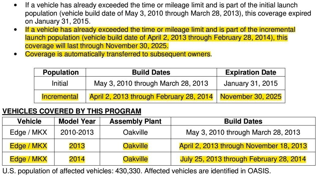

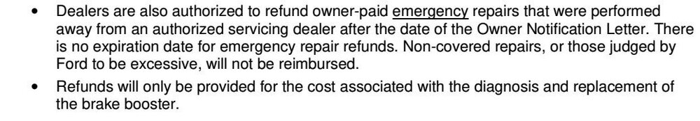

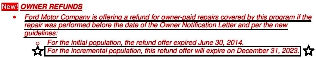

Supplement #2 Highlights
  • Eligibility expanded to additional 2013 & 2014 Edge/MKX vehicles;
  • Refunds for past owner-paid repairs to expanded vehicle population available through December 31, 2023 expiration date.
187879484_DealerPg3editedOwnerRefunds1HIGHLIGHTED.thumb.jpg.ecec8434b373dfa0215e029a56f3db75.jpg
233249187_DealerPg4editedOwnerRefunds2.thumb.jpg.70e3980da62ec8556ffd8ddf48c30b16.jpg

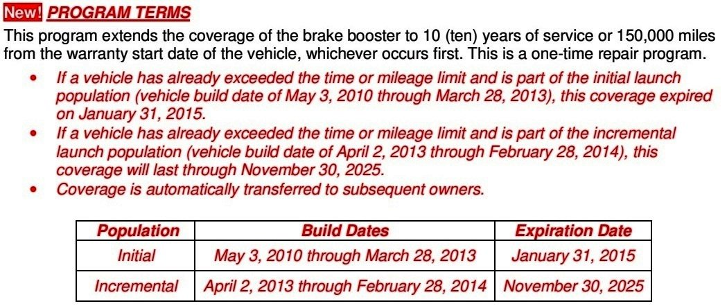

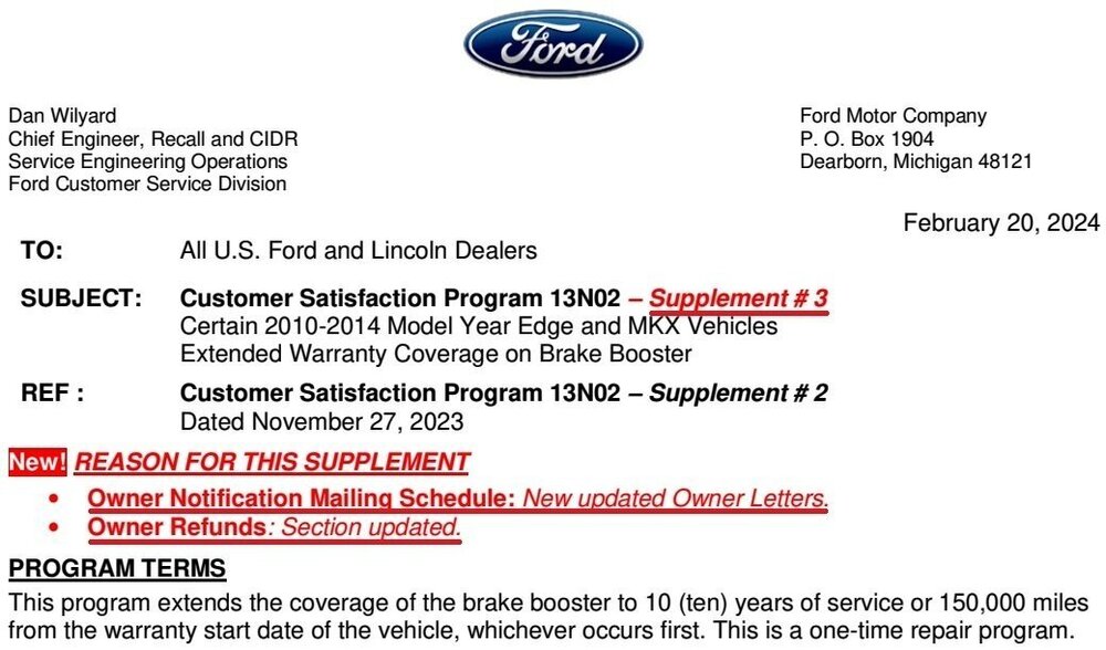

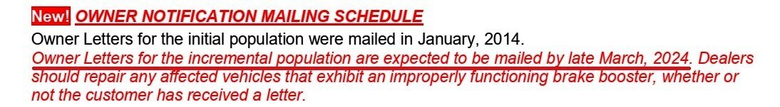

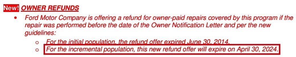

Supplement #3 Highlights
  • Updated letters to owners of incremental population 2013 & 2014 Edge/MKX vehicles will be mailed the week of March 18, 2024.
  • Refunds for past owner-paid repairs to incremental population of 2013 & 2014 Edge/MKX vehicles extended to April 30, 2024.
CSP13N02Supplement3-DealerBulletin-1.thumb.jpg.d5dbf5879bcc5c51124285a5ba325423.jpgCSP13N02Supplement3-DealerBulletin-1A.thumb.jpg.2ad40547eef2675c6a5bcad55d992c63.jpg
CSP13N02Supplement3-DealerBulletin-3.thumb.jpg.45caa118a7e80ae811110ac59f6e0ea1.jpgCSP13N02Supplement3-DealerBulletin-4.thumb.jpg.3bed98ea001193feafbcd059d09eac28.jpg

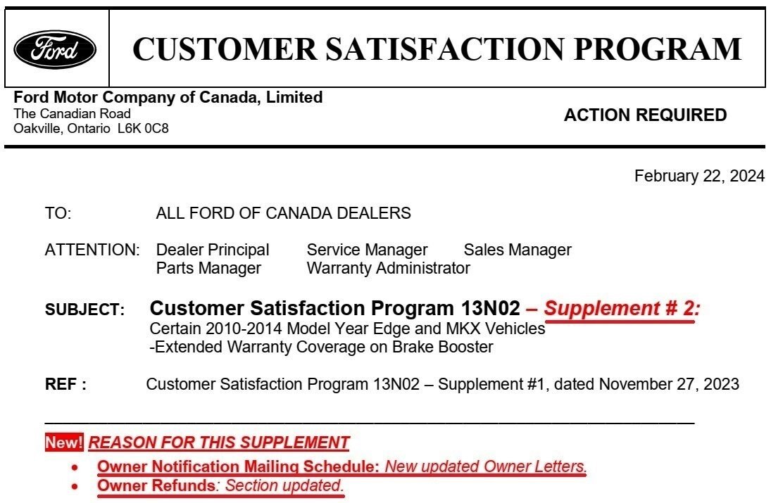

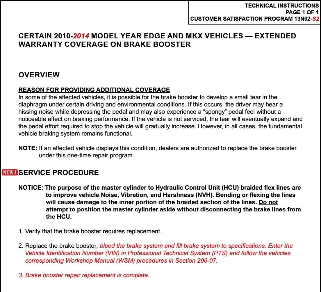

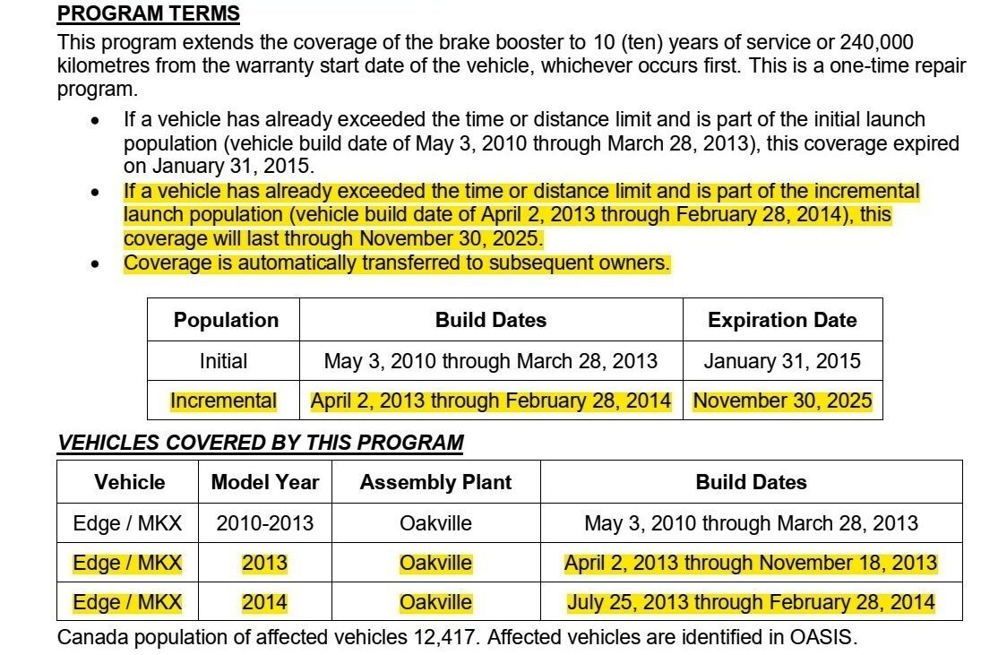

Canadian 2013 & 2014 Edge/MKX owners also benefit from CSP 13N02's extended Refund Program for owner-paid Brake Boost repairs...
CSP13N02Supplement2-DealerBulletin-Canada-1.thumb.jpg.f7d47a8225b05ad5eab8886dfe2eb89c.jpgCSP13N02Supplement2-DealerBulletin-Canada-1A.thumb.jpg.1dabe2e0951c72da02c0e1a77cd32930.jpg
CSP13N02Supplement2-DealerBulletin-Canada-2.thumb.jpg.b13e4cf0a9fda9fbdf0943196f211a49.jpg
CSP13N02Supplement2-DealerBulletin-Canada-3.thumb.jpg.642dbc746fcf6467b5f6f18c9154bfe9.jpg
