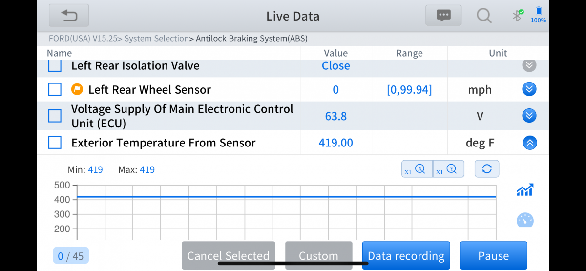

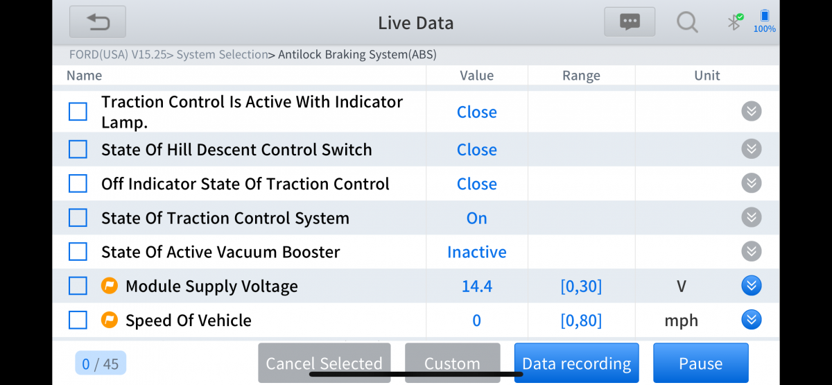

gwhamilton@gmail.com Posted November 23, 2023 Report Share Posted November 23, 2023 I have a 2013 Edge with brake problems. I changed the front pads and rotors about a month ago with no issues. About 2 weeks ago I noticed a soft brake pedal. I do have brakes but it takes quite a bit more travel. One additional odd fact is about once every day or two I get a very short and very light ABS feedback on the pedal while braking. This happens at about the half way point of pedal travel (normal brake engagement position). With the engine off, pumping the pedal gives a hard pedal at the normal pedal travel position. I have a bi-directional scan tool and I ran the ABS Special Functions test of the module and found no errors. I was also able to exercise all of the valves on the ABS module with no improvement. I had the master cylinder and booster replaced at a shop about a year ago. Is this something with the booster again? The shop used a Ford booster because they say they have bad luck with aftermarket. I’m not sure of the booster job is still under warranty. I can call and find out but I’d rather fix it myself if possible. Any idea on how to proceed? I have 2 screenshots from the scan tool but not sure if they are connected. One is ABS temp and the other is “State of booster vacuum…”. Temp seems high if it really is brake/fluid temp. Any help would be greatly appreciated. Quote Link to comment Share on other sites More sharing options...
JTW Posted January 27, 2024 Report Share Posted January 27, 2024 The hydraulic side of the ABS Module has an issue of a valve sticking open inside allowing fluid to bypass. You can replace the HCU and it will take care of the problem. Quote Link to comment Share on other sites More sharing options...
SpartanEdge22 Posted April 7, 2024 Report Share Posted April 7, 2024 On 1/27/2024 at 6:05 PM, JTW said: The hydraulic side of the ABS Module has an issue of a valve sticking open inside allowing fluid to bypass. You can replace the HCU and it will take care of the problem. Is this the abs control module (DT4Z2C219B) or is this more than that? This part is on national back order and I’m told by the dealership this is my problem but I’m SOL because it’s not available. Quote Link to comment Share on other sites More sharing options...
