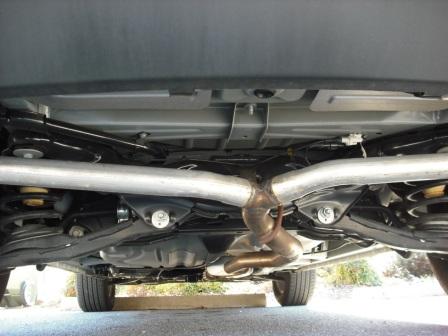

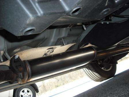

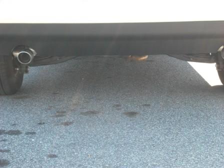

chardylo Posted February 5, 2009 Author Report Share Posted February 5, 2009 Attention, Attention. I know I said that removing the resonator was sufficient, but I must admit I got greedy. I just got back from having a local muffler technician make me a custom CAT system with a Magnaflow muffler. The sound is unbelievable. Will post pics and audio / video ASAP. I can tell a slight gain in torque and a little in hp around the 3k rpm range. He was able to use the existing stock pipe instead of enlarging the pipe to 3' or so. The muffler was placed in the position where the resonator was directly beneath the seating area and then he made a y pipe at the end and was able to keep the stock tips. Materials including labor cost me a whopping $128 plus tax. Very Very well worth the money. From what I heard of the clips of the Gibson and FM Delta series, I got much more bang for my buck. ok, here are 3 pics of the installation done about 2 hours ago. Will have to add audio another time, I don't have that capability on my phone. Quote Link to comment Share on other sites More sharing options...
chardylo Posted February 5, 2009 Author Report Share Posted February 5, 2009 ok, here are 3 pics of the installation done about 2 hours ago. Will have to add audio another time, I don't have that capability on my phone. Sorry, forgot the part number. Magnaflow Part # 11132 Quote Link to comment Share on other sites More sharing options...

Lex Talionis Posted February 5, 2009 Report Share Posted February 5, 2009 ok, here are 3 pics of the installation done about 2 hours ago. Will have to add audio another time, I don't have that capability on my phone. have not been under my car in a while, so cannot recall if there is a reason, but what is with the gnarly bend in the pipe from the muffler back? why is it not straight shot back as it does not look like it is jogging around anything from that photo? Quote Link to comment Share on other sites More sharing options...

chardylo Posted February 6, 2009 Author Report Share Posted February 6, 2009 have not been under my car in a while, so cannot recall if there is a reason, but what is with the gnarly bend in the pipe from the muffler back? why is it not straight shot back as it does not look like it is jogging around anything from that photo? The part of the pipe that bends from the muffler to the Y split is part of the stock exhaust. The only new piping he used was the Y pipe to the tips. Quote Link to comment Share on other sites More sharing options...
Lex Talionis Posted February 6, 2009 Report Share Posted February 6, 2009 The part of the pipe that bends from the muffler to the Y split is part of the stock exhaust. The only new piping he used was the Y pipe to the tips. well heck.. if he was under there.. should have had him cut that out and make a straight shot. more turns and bends like that just add to back pressure. and in this case, it is not like that bend is needed to job around the tranny or something.. should have had him take it out. for what he seems to be charging you, could have been done cheap Quote Link to comment Share on other sites More sharing options...
Waldo Posted February 6, 2009 Report Share Posted February 6, 2009 well heck.. if he was under there.. should have had him cut that out and make a straight shot. more turns and bends like that just add to back pressure. and in this case, it is not like that bend is needed to job around the tranny or something.. should have had him take it out. for what he seems to be charging you, could have been done cheap Running the hot exhaust right next to the fuel tank should be fine, right... Quote Link to comment Share on other sites More sharing options...
Lex Talionis Posted February 6, 2009 Report Share Posted February 6, 2009 Running the hot exhaust right next to the fuel tank should be fine, right... your kidding, right? go do some research. you really think an exhaust that is bent 4 inches out of the way is a significant heat cut back.. heck, even do some research on this site, and you can see straight exhaust pipes to cut down on curves and bends. As far as I know 818EDGE has not blown up yet with his Gibson.. ha ha ha maybe you better call Magnaflow and alert them also Quote Link to comment Share on other sites More sharing options...
