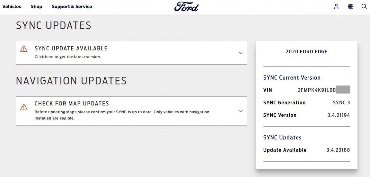

Haz Posted October 7, 2023 Author Report Share Posted October 7, 2023 SYNC 3.4.23188 is shown as the latest release on OASIS and on the Ford Owner Support SYNC Update website for several 2019 & 2020 Edge VINs of vehicles offered for sale online, which I checked. This 2020 Edge SEL shows the most recent previous release SYNC3 v3.4.21194 is presently installed and the SYNC 3.4.23188 update is available for installation... ...And the OASIS SYNC Service report for this 2020 Edge SEL shows its current SYNC 3.4.21194 is the result of an update made by its selling dealership on August 16, 2023. Good luck! 2 Quote Link to comment Share on other sites More sharing options...
