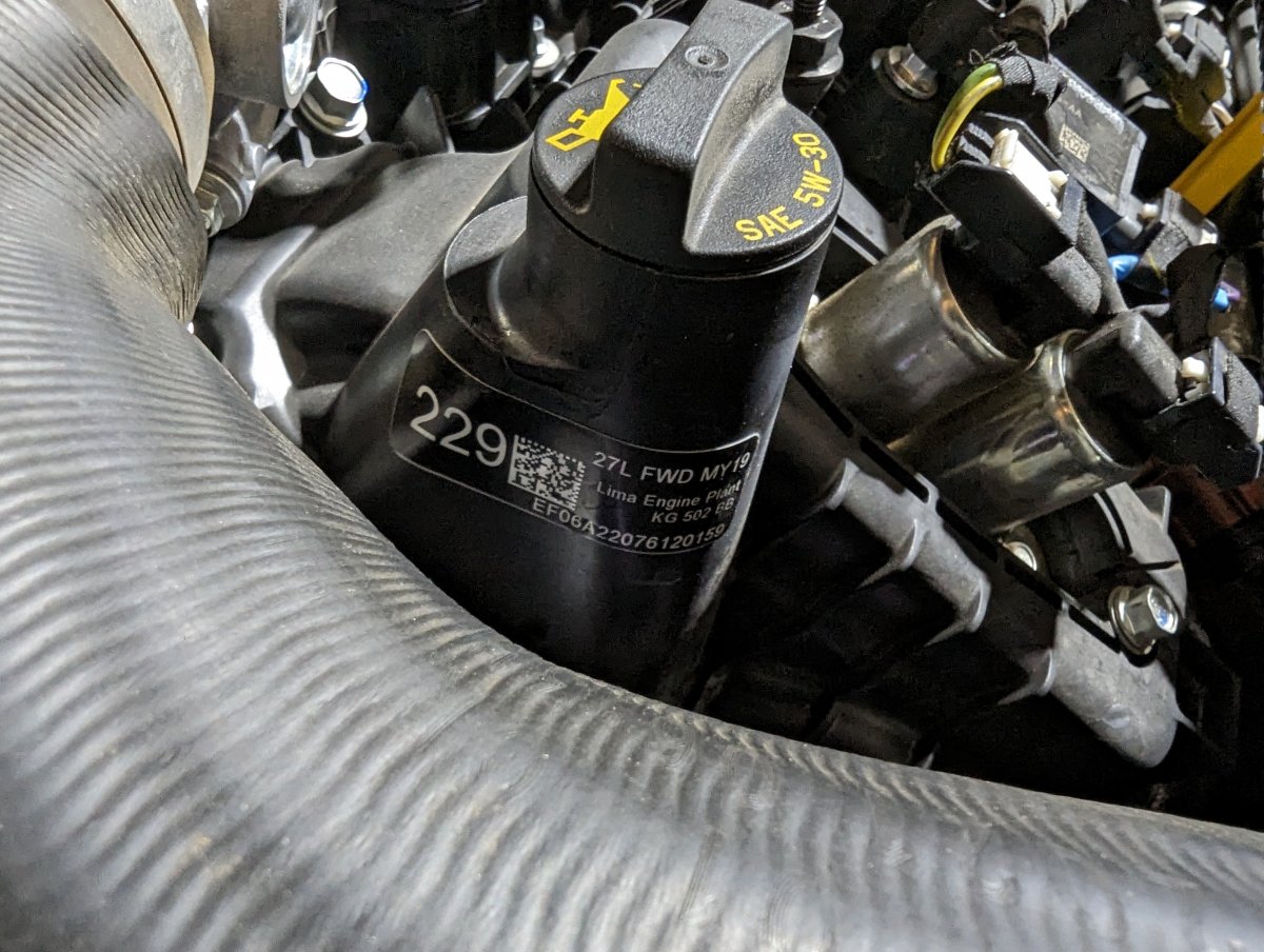

So the big question for me is how can I find the engine build date for my 2022 ST with this engine?  The assembly date was in early April of 22 and I didn't get the car until late April 22, and it says they changed the way the parts were made to eliminate the problem in engines during October 21.  Would be nice to see if mine was made before or after that date.  Don't know if the engines are made just shortly before assembly, or if they're stored for months prior to going in a vehicle.  I can't find anything on the engine except this large sticker near the oil filler.  Could 229 mean 2022 February 9th?

Thanks Haz!  Well, the photo I attached to my last message shows the label that is on the left hand side of the valve cover (standing in front of the vehicle).  Could that be the label for the engine even though it doesn't look to be the same color as the example label in your post?  It appears that is from a 2014, and possibly the label is black with white letters now.  If that isn't the label, I have no idea where in the heck the vaccuum pump is located.
If this is the correct label, then I'm in luck because that engine was built on March 17, 2022, well after the October 2021 date when they changed the type of metal in the valve.  Thanks!  One odd thing is my label also shows FWD as the "drive type" even though all the STs were AWD in 2022.  I suppose that engine works in either type of drive, so maybe they simply specify it as compatible for FWD.
Probably means the engine is for FWD based platforms like the Edge with transverse mounted engines, whereas the Bronco which is 4WD, has RWD in the engine label as it is RWD based with longitudinal mounted engines.
