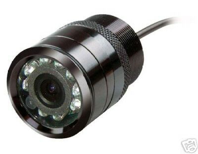

BTW, above end mentions "bullet style camera" - this might be the actual option for you. I considered this as well. these are cameras that are flush mounted in the bumper and look like a reverse sensing sensor when mounted. need to drill a hole in the bumper, but when installed and flush mounted, pretty clean. I looked at a bunch on ebay ('rearview camera') when I was considering my options.. tons of styles and qualities, but for sure, you could do this option.
