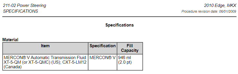

EddieHudson Posted August 15, 2023 Report Share Posted August 15, 2023 My 2010 AWD uses Mercon V not power steering fluid. Try doing a flush and putting in the correct fluid. Quote Link to comment Share on other sites More sharing options...
Haz Posted August 16, 2023 Report Share Posted August 16, 2023 (edited) Welcome to the Forum, CEdge2010 ! From the 2010 Edge Workshop Manual... Power Steering Fluid Leak Test NOTE: This test should only be carried out if a leak in the system has not been detected during a thorough visual inspection. Refer to Inspection and Verification in this section. Remove the power steering pump reservoir cap and check the power steering fluid level. If necessary, add the specified power steering fluid. Tightly install the Power Steering Evacuation Cap onto the reservoir and connect the Vacuum Pump Kit to the Evacuation Cap. Using the Vacuum Pump Kit, apply 68-85 kPa (20-25 in-Hg) of vacuum to the power steering system. Observe the vacuum gauge for 30 seconds. If the vacuum gauge reading drops more than 3 kPa (0.88 in-Hg), a leak is present. Remove the Vacuum Pump Kit. Start the engine and insert the Dial Thermometer into the Evacuation Cap. NOTICE: Do not hold the steering wheel at the stops for an extended amount of time. Damage to the power steering pump may occur. With the engine at idle, raise the power steering fluid temperature to 74-80°C (165-176°F) by rotating the steering wheel fully to the left and right several times. Stop the engine and visually inspect the system for leaks. If a leak is evident, repair as necessary. If a leak is not evident, add the specified UV fluorescent tracer dye to the power steering fluid. Use 14.78 ml (1/2 oz) of dye solution for every 1.89L (2 qt) of power steering fluid. Start the engine. NOTICE: Do not hold the steering wheel at the stops for an extended amount of time. Damage to the power steering pump may occur. With the engine at idle, raise the power steering fluid temperature to 74-80°C (165-176°F) by rotating the steering wheel fully to the left and right several times. Stop the engine and inspect the system for traces of UV dye using the 100W/12 Volt DC UV Lamp. Repair as necessary. Document download links> Power Steering System Flushing - General Procedures - 2010 Edge Workshop Manual.pdfFetching info... Power Steering System Purging - General Procedures - 2010 Edge Workshop Manual.pdfFetching info... Power Steering System Filling - General Procedures - 2010 Edge Workshop Manual.pdfFetching info... Good luck! Edited August 16, 2023 by Haz 1 Quote Link to comment Share on other sites More sharing options...
CEdge2010 Posted August 16, 2023 Author Report Share Posted August 16, 2023 On 8/15/2023 at 11:27 PM, EddieHudson said: My 2010 AWD uses Mercon V not power steering fluid. Try doing a flush and putting in the correct fluid. Expand Now that I have looked into this, it makes perfect sense. Thank you for bringing to my attention. I will definitely be doing this and will report back with results. Quote Link to comment Share on other sites More sharing options...
