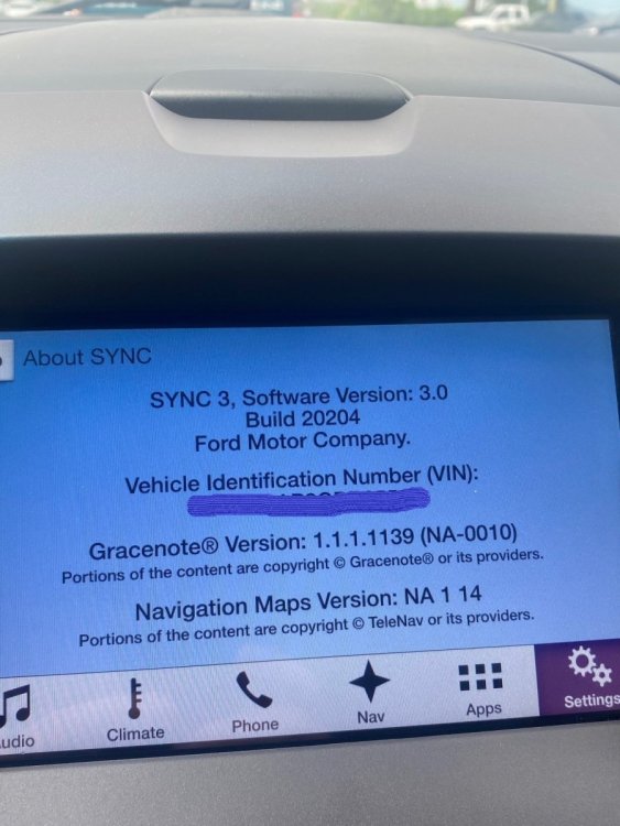

danostuff Posted August 11, 2023 Report Share Posted August 11, 2023 (edited) I have battled with upgrading the Sync3 system from version 1.0 to 3.0. Finally got it to update, but I don't think it was the full update. I ordered the HC3Z-19A387-F USB module and they sent the HC3T-14F014-BE module. Installed this (Tried two modules with the same model numbers) and the system recognizes my iPhone, but Carplay does not start. What should my next steps be to try to get this working? BTW.. It still shows a star instead of the arrow for the navigation system. Any way to verify the entire software upgrade was successful? A popup also appears every so often "USB hubs are not supported. Please remove" Any help would be appreciated. Thanks Edited August 11, 2023 by danostuff Add narrative Quote Link to comment Share on other sites More sharing options...
dabangsta Posted August 11, 2023 Report Share Posted August 11, 2023 Was the USB hub from a Ford dealer, or from an online seller or very specifically from China? 3.0 supports CarPlay (2.2 does as well). While that popup error usually is related to the hub as it says, have you tried other USB cables? My 2017 Escape at first seemed to be very finicky about them (maybe it was the initial update from 1.1 to 2.2, then eventually to 3.0 made it better?), and maybe the cheap knock offs are better now, but most of them I try now work. I get very funky ones, like 6 inch long, 90 degree on both sides, so fit in the cubby and make the other drivers not try to use their phones while driving. Quote Link to comment Share on other sites More sharing options...
danostuff Posted August 11, 2023 Author Report Share Posted August 11, 2023 Yes bought from a dealer. They said that was the one. USB error is without a cable hooked up. Quote Link to comment Share on other sites More sharing options...
