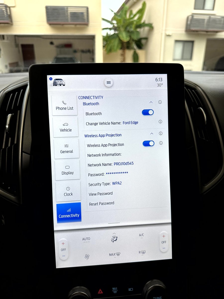

I recently got a brand new Ford Edge SE 2022 and I love it but I have a problem: First let me start by saying this, I live in Panama, that's where I got the car on a local Ford dealership, the car as far as I can tell from the VIN was built in Canada.

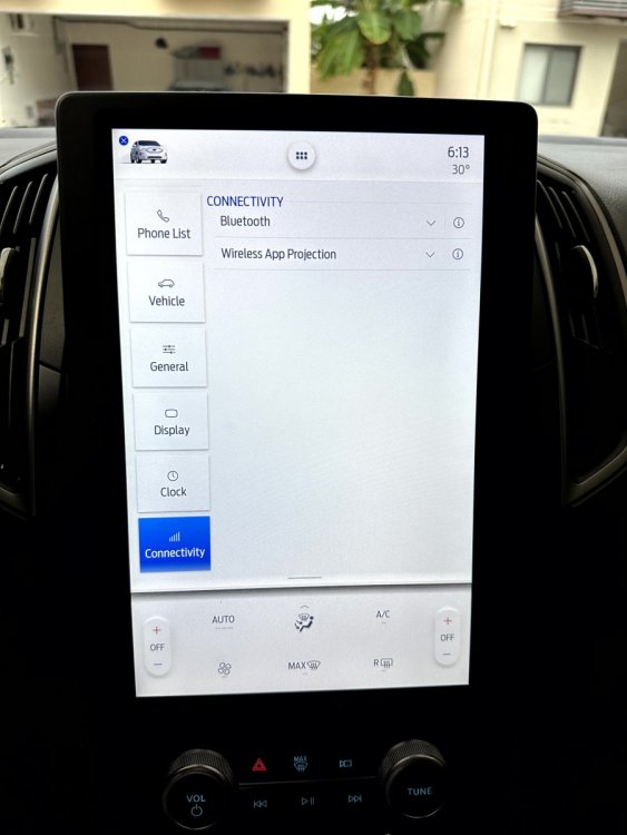

Here is the problem: one of the first thing I tried when I got home was trying to check if there was any software updates for the Sync system, but to my surprise I'm unable to connect the car to a WiFi Network simply because the option on the connectivity menu its unavailable as you can see from the pictures. I'm able to use my iPhone with CarPlay no problem and able to connect my iPhone via Bluetooth no problem either to play music that way, but unable to connect the car to my iPhone hotspot or any other WiFi network at all.
I already tried to do a factory reset on the sync system and it did but still have the same problem. All I can think is that this is some kind of international country restrictions, I don't know, and I need help figuring this out.

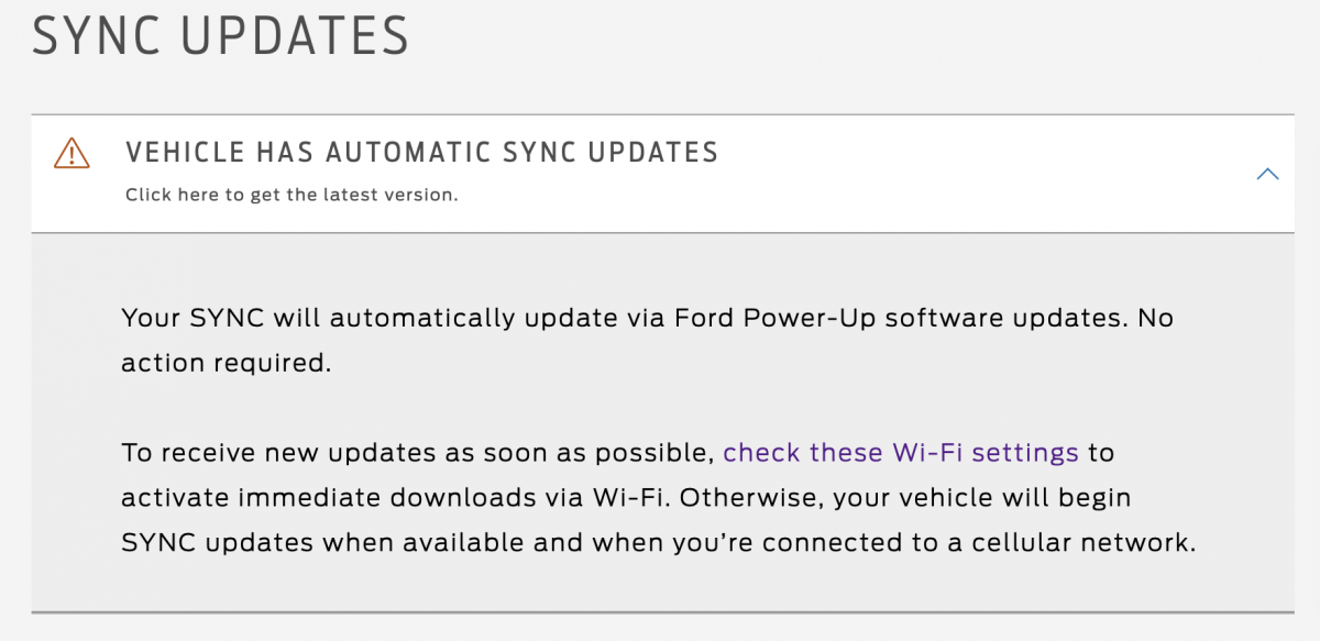

Thanks for your reply, I went to the page and register and it basically tells me that my car has automatic updates, but I need to enable the wifi settings to get the updates, and the problem is I cannot enable the wifi settings

They don't even have the option to select a wireless network. That Wireless Projection setup is for wireless Android Auto/Carplay.

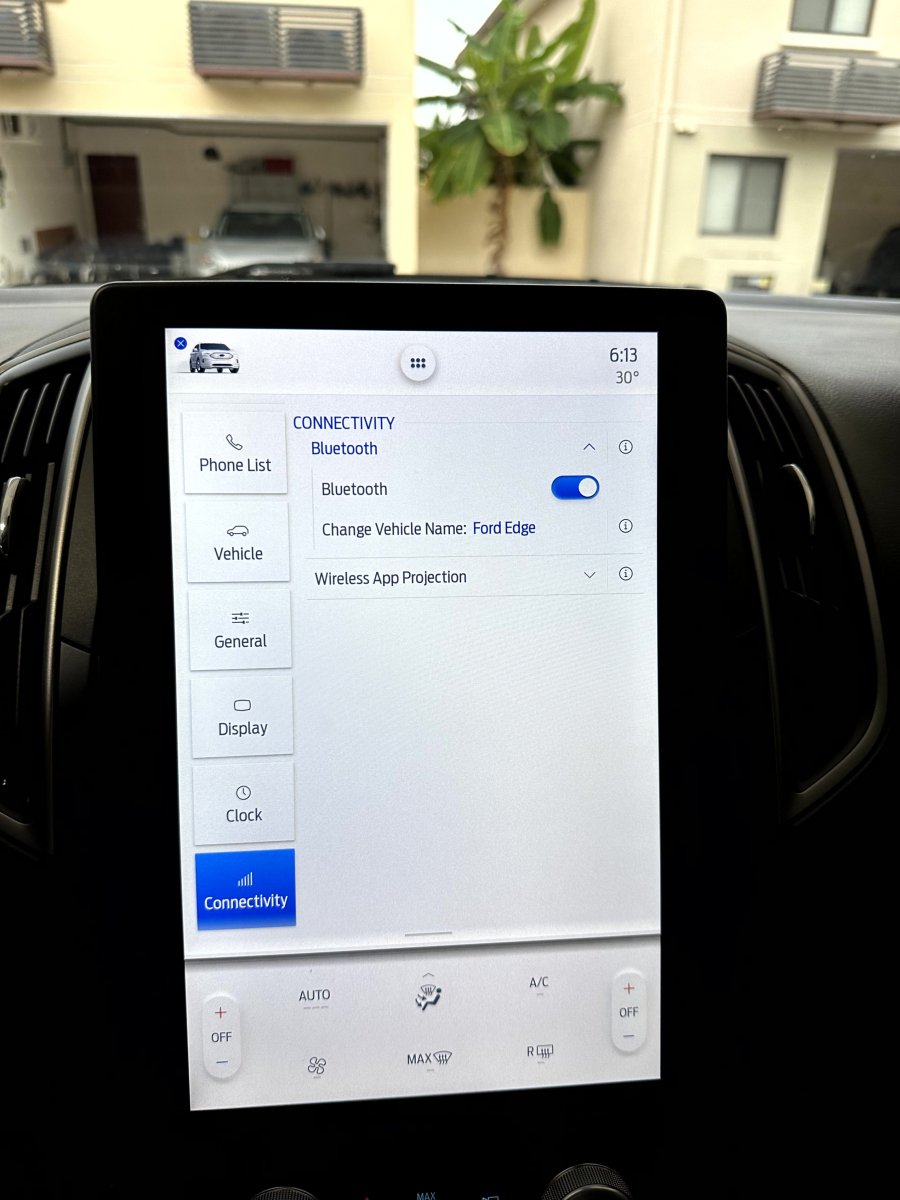

I see your point but my problem is that I cannot even get into a menu to select a list of available networks. The option is disabled

yeah I’m sure it’s an export thing… however I was wondering if this can be re-enabled with something like Forscan or FDRS

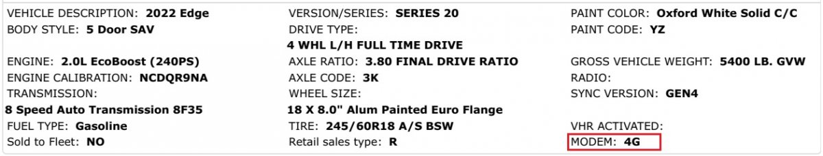

This is in contrast to a comparably equipped USA-market 2022 Edge SE's OASIS report shows 4G as this vehicle's Modem type...

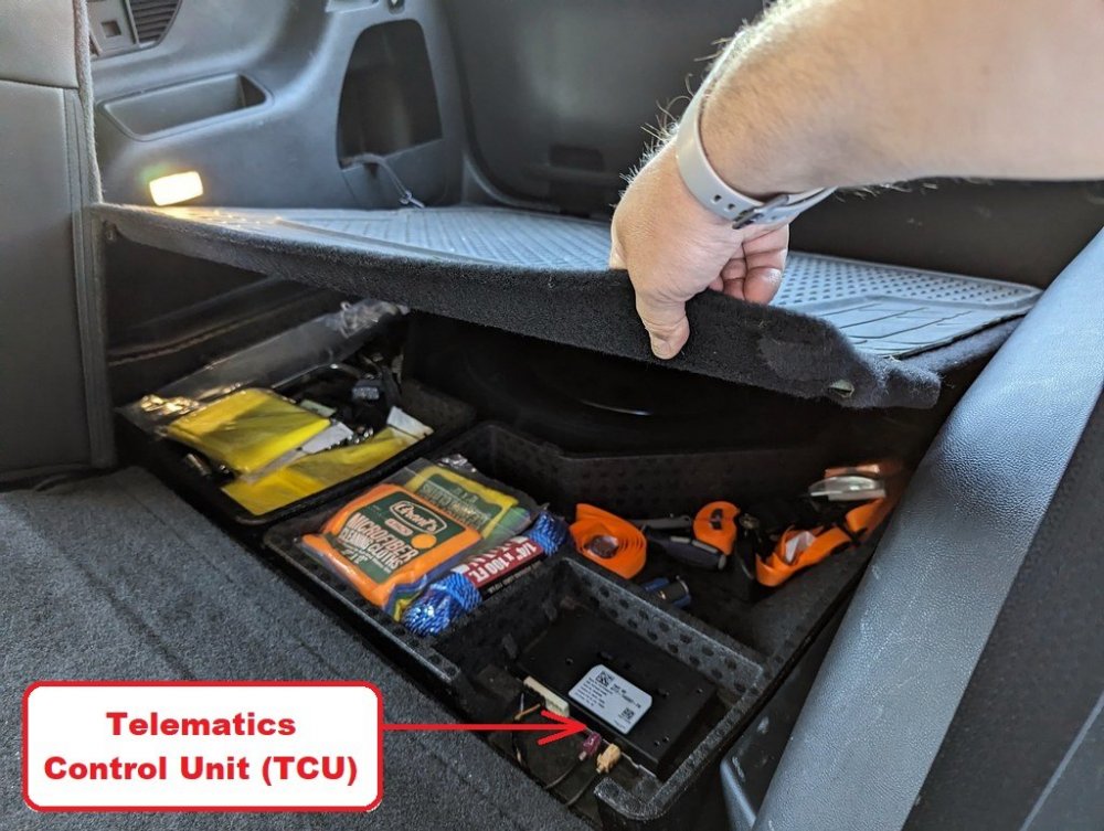

Physically checking your Edge for an installed TCU is quick and easy, and could be worthwhile.
With appreciation to Forum member dabangster for this photo, if you fold down your Edge's left hand second row seat, and lift the forward corner of the cargo floor cover, you may or may not see an installed TCU...
1270936528_TCUshowninForumMemberdabangstaspreviouslypostedphoto.thumb.jpg.e6150a9e83342cdd25f61e6351b9d2a2.jpg
If you do find an installed TCU, you could perform the Bezel Diagnostics procedure to assess it, though lacking As-Built data, TCU diagnostics will likely not be viewable...

This is a lot of very clear information @Haz and confirms the fact that the car does not have the capability, I checked on the place the TCU is suppose to be and is not there so that confirms it as well.
