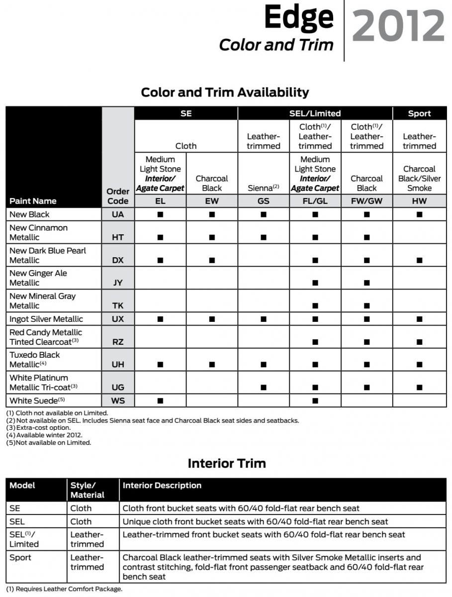

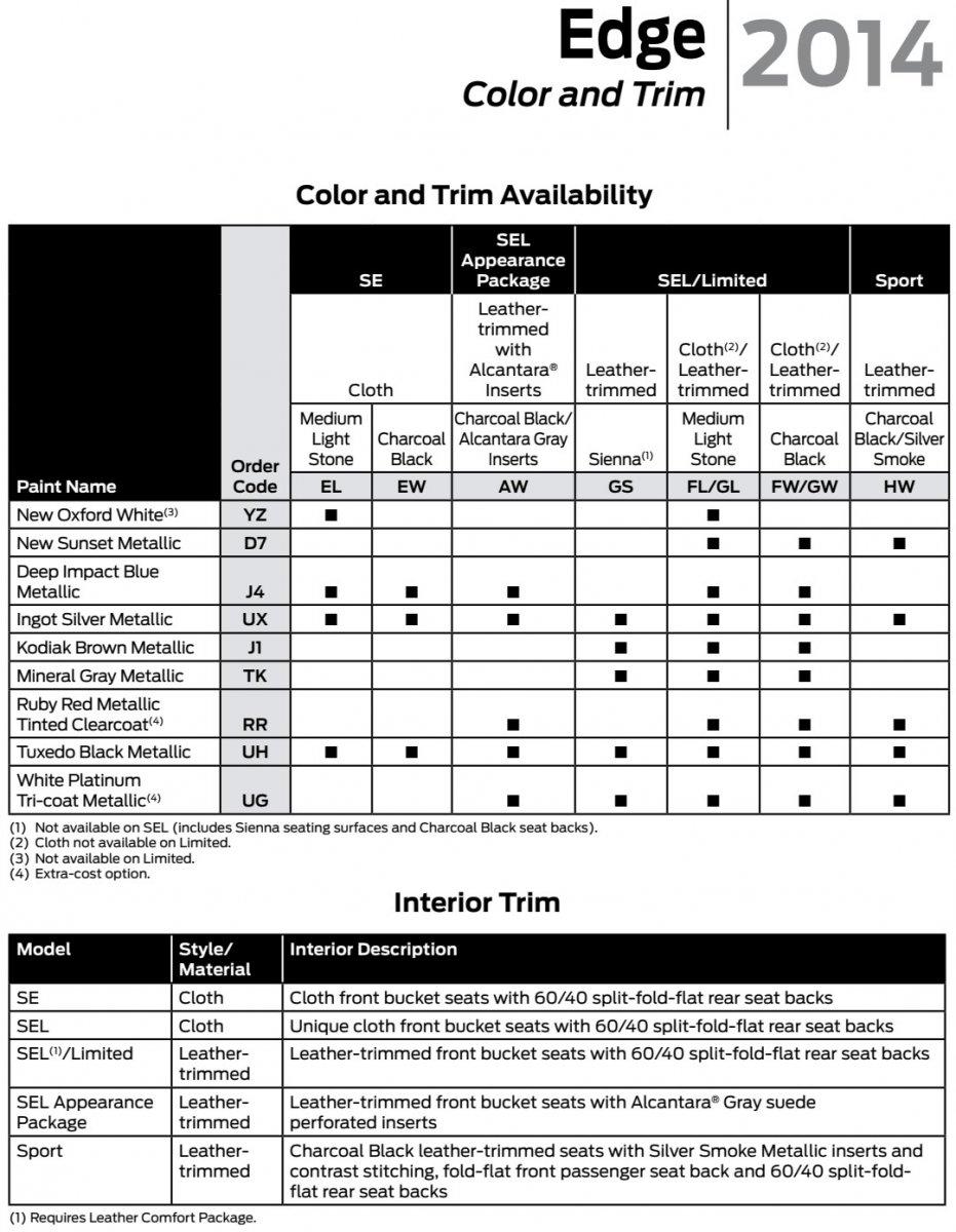

Comparison of 2012 Edge and 2014 Edge interior color availability...
Versus...
1683853800_2014EdgeInteriorColors.thumb.jpg.670414d6360c06e65a29cb6302c1e7a6.jpgua

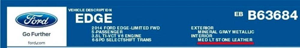

Presumably, your Edge's seats that you describe as being Sandstone are actually Medium Light Stone...
From a CarGurus.com listing,  VIN of 2014 Edge Limited with Medium Light Stone seats: 2FMDK3KC5EBB63684...

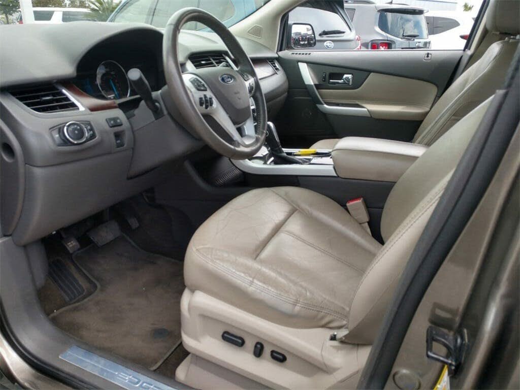

Photo of this 2014 Edge, showing seat upholstery design and color consistent with photo you posted...
