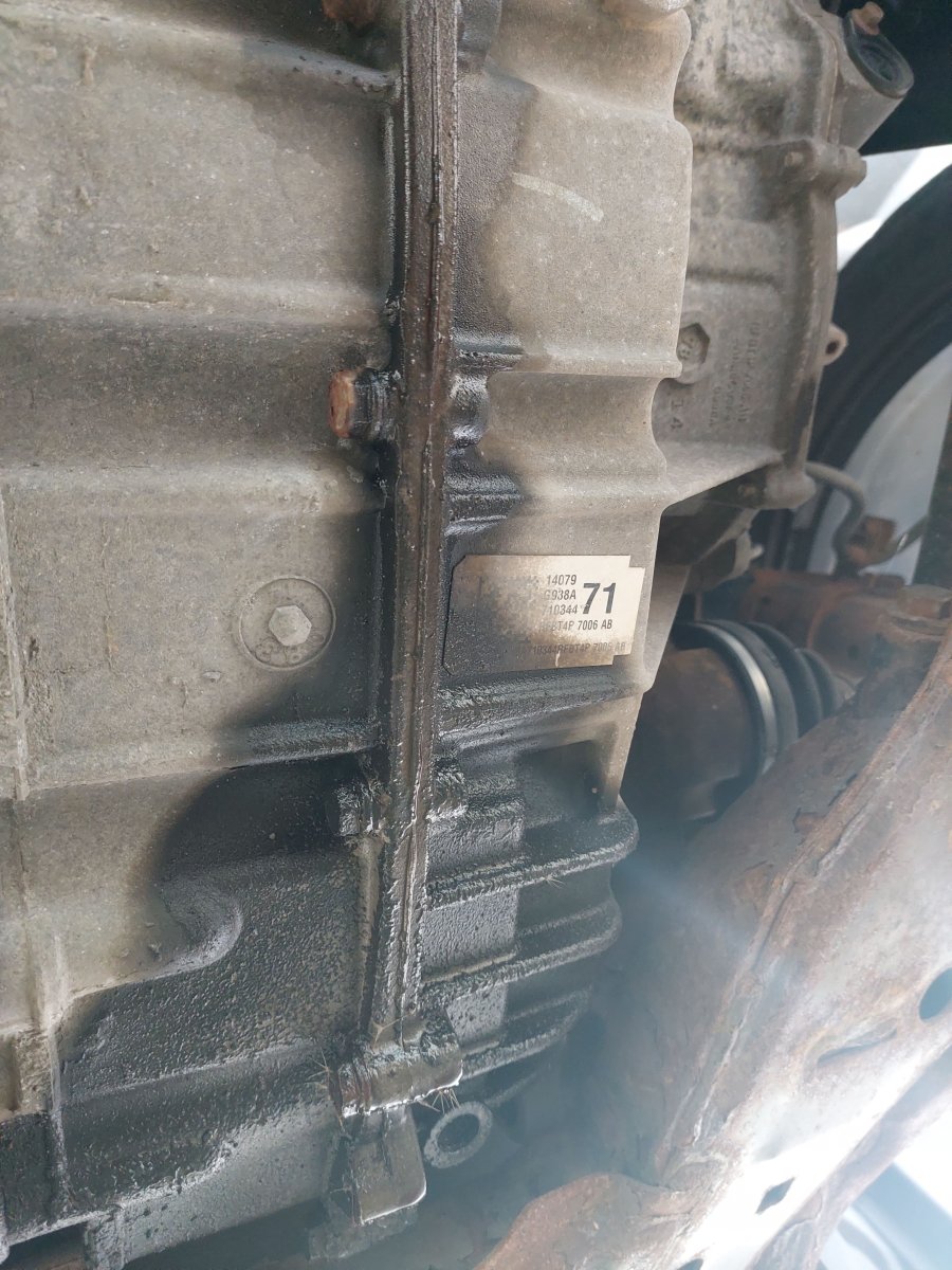

Can you tell what is the  color of the leaking fluid?
If thinner red\pink, then it's likely Trans MerconV ATF leaking.
If thicker\darker\black, then it's likely PTU GearOil.
May want to try a carwash with a bottom spray wash or use BrakeCleaner to clean up the area,
then trace any fresh leaking fluid to it's highest originating spot.
