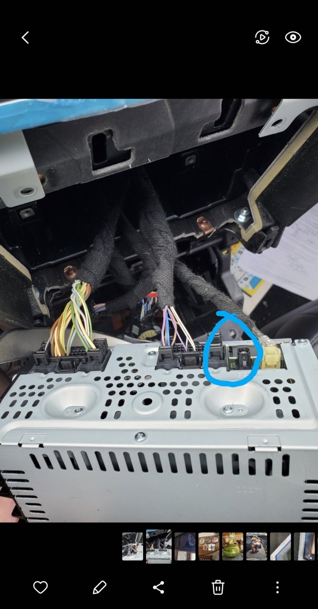

I bought an upgrade kit to upgrade from the Sync 2 to Sync 3. Overall the upgrade was pretty easy and straightforward. I did however disconnect the cd player/brain of the radio system which I didn't need to do to begin with. In doing so I broke the plastic connector and trying to fix it I completely tore up the tip of the cable. I'm going to have to cut off the end of the cable and replace it but I don't know what it is called, what to search for or where to search. Please help.

Little confusing. Is it the socket on the radio or the plug on the end of the cable that buggered up? A better picture (close up) of the actual damage might be if help.
You need to accept that neither are easy to find as a repair item. You will probably need to make a jury-rigged connection to remake the connection. Or send the radio into a repair service. I doubt these sockets are readily available to the public.
If it's the plug end, you'll probably have to get a partial cable (a cut off) from a junk yard and splice it onto your existing cable assy.

As enigma-2 mentions, seeking a cutoff cable end from a salvage yard should be far easier than replacing the full antenna cable, which I'll describe shortly.
In order to locate a potential connector-donor Edge in your area, you could try the Car-Part.com search engine...
...and designating on the secondary Search page...
...and while the search results are for Edges equipped with the same radio/Front Audio Control Module (ACM) as your Edge...
...this should ensure that the antenna cable-end connector-cutoffs the salvage yard provides you will match-up with your Edge's ACM/radio...
1987781812_Screenshot_20230614_175943_Gallery-CroppedEnlarged.thumb.jpg.5ff4d00f8e42ef243e3d0f365be7557b.jpg
If you know your way around a soldering iron and some electrical tape, this will be easier than entirely replacing the front-to-rear antenna cables, as described in the following Workshop Manual section...

It's worth noting that the ACM wiring diagram lacks any antenna cable-end connector identifier and also shows the antenna cable is one-piece from rear-to-front...
169404078_AudioFrontControlModule-WiringDiagramHIGHLIGHTED-2015Edge.thumb.jpg.eaca9a646bdaec87014863e5526700f5.jpg
...whereas the replacement antenna cable is two-piece and is zip-tied to the harnesses containing the original antenna cable from the rear
