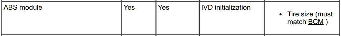

Hi, I have a problem with changing the size of the tires in forscan, changing the circumference in BdyMC , it shows me an error in PMC, I have performed the learning procedure in PMC (relearn vehicle data) the error still occurs. I will add that I have tire size only in one place ( from what I was able to find in BCM module). Does anyone have any idea . Edge 3.5L FWD 2016
When I changed tire size on my 2015 MKX -- which is a Gen 1+ vehicle and not Gen 2 like your 2016 Edge -- it was necessary to make the tire-size change in the Body Control Module and the ABS module, per the 2014 Edge Workshop Manual's module configuration guidance (edited to apply to your question)...
image.thumb.png.c6c356ef077ba9134c42f6363730d998.pngimage.thumb.png.8ae93a14ec648e0eb4ac50a71aa299d4.png
