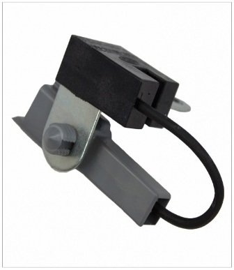

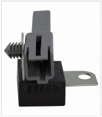

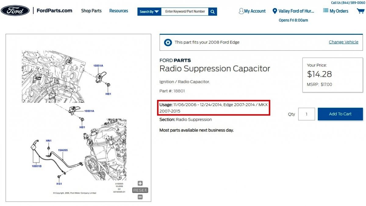

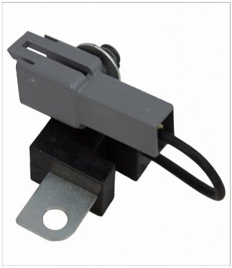

Not sure about your 2015, but on my 2008 Edge there is a RadioNoiseReductionCapacitor, specificly to eliminate this static problem.
Its wired to the GroundingWireTerminal next to the  main PCM computer terminals on the left FireWall above the Engine.
When electrical connections are removed+replaced, this Capacitor is often mistakenly left disconnected or never reinstalled.
Tornado\StormChasers traditionally disconnect this Capacitor so to listen for nearby LightningStrikes via the AM Radio band.
With Capacitor disconnected, can hear ignition sparks varing with EngineRPM or LightningStrikes with AMRadio tuned between stations.
Older vehicles with single IgnitionCoils have this Capacitor connected between the 12v supply wire to the Coil & frame ground.

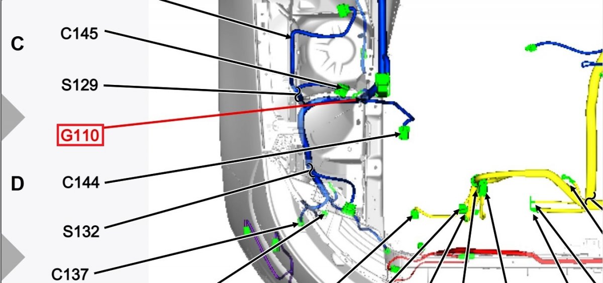

On the 2015 Edge, for all engines, the Powertrain Control Module (PCM) grounds terminate underhood on the vehicle's right hand side at G110, per the below wiring diagram and wiring location illustration...

@Haz
Yep that's the Capacitor part# 18801, just a little black box about 1"square with a wire pigtail & spade connections.
It's mounted on the FireWall frame ground post next to the PCM, pigtail end connects to the Engine ground,
so no direct connection to the 12 coil supply, kinda weird.
But seems to work as there is no ignition static on the 2008 stock AM\FM radio.
Edited by DILLARD000
