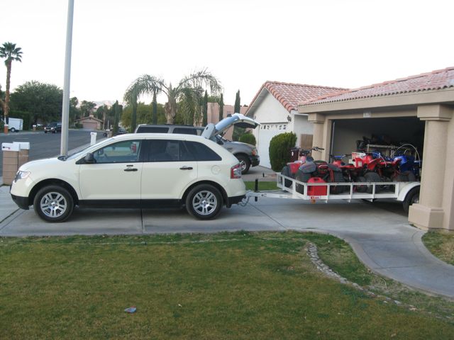

bfeagle Posted January 26, 2009 Author Report Share Posted January 26, 2009 What would you pull with an edge? I can't think of anything I would pull with my wifes edge. But I drive a f-350 diesel and pull what ever I want too. See the attached photo.. I pull my small trailer with quads. I also uploaded a picture of said mystery harness that should be for trailer lights. Bruce Quote Link to comment Share on other sites More sharing options...
